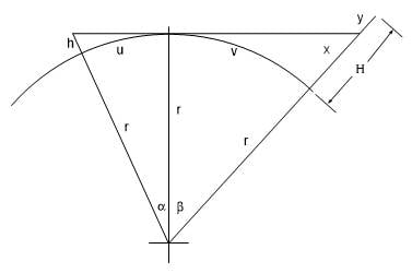

The picture is below. You are given ##h,~H,~r,\text{ and } d= u+v##. So ##\alpha = \arccos\frac r {r+h}## and ##u = r\alpha##. So ##v = d -u## and ##\beta = \frac v r##. Then ##\frac {r+x} r = \sec\beta## so
##x =r\sec\beta - r## and ##y = H-x##. Just plug in the numbers as you go.

Yes, thank you. That works quite well. However, another given would have to be either d or v, since we only know the value of u and v = d-u contains two unknown values. At least, I couldn't go any further until I plugged in a value for v. Using h = 6/5280 miles, r = 3960 miles, and H = 200/5280 miles, I got y = 103.99963 feet. Using the Pythagorean method, I got y = 104.00022 feet, a difference only 0.0006 feet, which is negligible. Your method appears to be quicker and does avoid square roots.
But, there does seem to be a problem here. Calculating the distance from the observer to the island using arc length only takes into account the distance along the surface (abc in the diagram below), not the line-of-sight distance (dbe). The line dbe is longer than the arc abc, although in models such as this, where r is very large and h, x, y and H are very small, it hardly makes any difference. But I think I'll stick with the Pythagorean method for this type of problem, because it involves straight lines of sight (not including refraction).

As I said in my post, you are given ##d## which equals ##u+v##. Your original problem had ##d = 15##.
I thought that was probably the case. But you didn’t address the second part of my post, which discusses whether the observer is viewing along the surface of an arc, or using line of sight from their vantage point.

You don't have to guess. Look at the picture below. Calculate ##d## and ##s## in terms of the angle ##\alpha## and radius ##r##. Can you see why ##d>s##?

I don't understand this question. You can't see around corners.

I’m measuring the distance by line of sight, not by the distance along the surface. How far you can see is not the same as arc length - it’s a straight line.
I understand how you are measuring the distance. It's your problem and you can do it any way you wish. I am just pointing out that the standard way to measure the distance between two points on Earth is along an arc on the surface between them. If the Earth were a perfect sphere these arcs would be on great circles. And, as you have noticed, for your particular calculation it doesn't make much difference.
