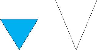

Indulge us and make a drawing ... perhaps these vertices are at the bottom and the bases are at the top ?
And the pipe can't really be that short, can it ? :smile:
That's what I am wondering about too... I even thought there could be a wormhole connecting the two of them. But seriously there is no drawing or anything like that. What I typed is the whole problem itself.

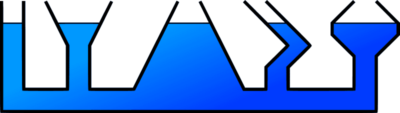

This ring a bell ?
BvU said:
This ring a bell ?
Wow. How long did it take you do draw this?
Chet
I can draw fast, but this one was stolen -- oops, I hope I don't run into trouble over it ... (it appears to be clickable too ! :wink: )

Well, you already gave an expression (*). Let's take it all seriously and assume that the vertices are really at the bottom end and the bases up in the air.
Snag: d is now d(h) if h is not the full height any more ...

Here's the drawing you should have made. To scale!

That's why I pointed you to Pascal's Law, and BvU kindly posted the graphic in Post #10.
Both are saying the same thing: it's not the volume which causes pressure, it's the ?

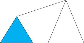

This is what my old paranoid self thought of in post #3
You know: base at the base and vertex at the top...
ROTFL they say nowadays :smile:
