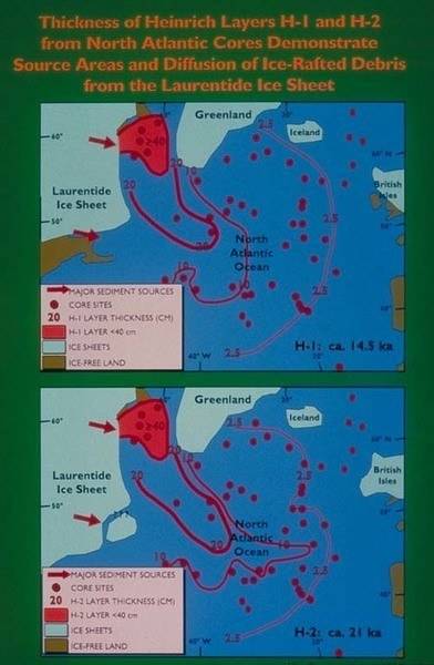

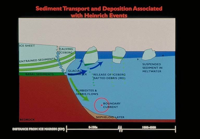

There's been so much research on the iceberg armada events (Wikipedia Heinrich events) since the classic 1988 paper by Hermut Heinrich himself. There's a host of different data concerning the events, so why is still such a mystery? Here's an excellent introduction to the research carried out in slide show format Paleo Slide Set: Heinrich Events: Marine Record of Abrupt Climate Changes in the Late Pleistocene.
Here's a 2009 report which links the events with abrupt changes in Indonesian waters http://www.agu.org/pubs/crossref/2009/2008PA001653.shtml. What's going on?

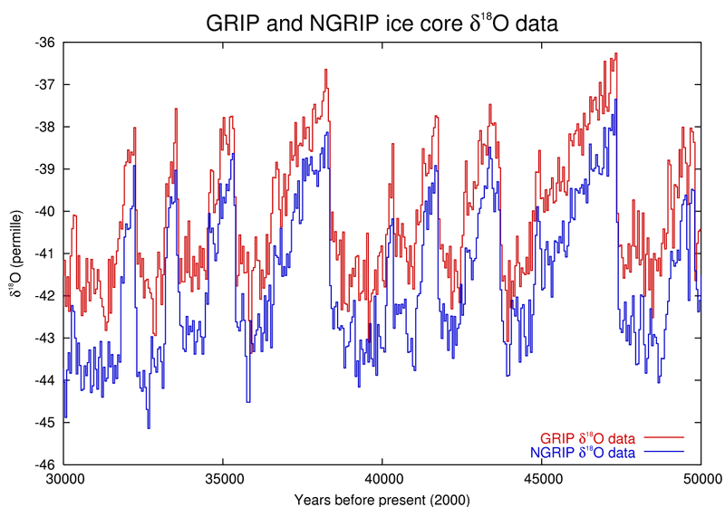

Wikipedia: Dansgaard-Oeschger events:
Effect
In the Northern Hemisphere, they take the form of rapid warming episodes, typically in a matter of decades, each followed by gradual cooling over a longer period. For example, about 11,500 years ago, averaged annual temperatures on the Greenland icepack warmed by around 8°C over 40 years, in three steps of five years (see Alley (2000), Stewart, chapter 13) - 5°C change over 30-40 yrs more common.
Heinrich events only occur in the cold spells immediately preceding D-O warmings, leading some to suggest that D-O cycles may cause the events, or at least constrain their timing (Bond & Lotti 1995).
The course of a D-O event sees a rapid warming of temperature, followed by a cool period lasting a few hundred years (Bond et al.. 1999). This cold period sees an expansion of the polar front, with ice floating further south across the North Atlantic ocean (Bond et al.. 1999).
Also, rather interestingly, it quietly states:
The little ice age of ~400 to 200 years ago has been interpreted as the cold part of a D-O cycle, putting us (even without the effects anthropogenic global warming) in a period of warming climate (Bond et al.. 1999).
