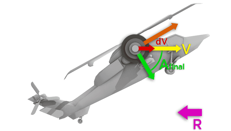

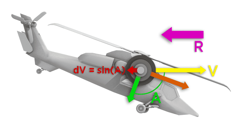

Hello again everybody.
Encountered another challenge with the helicopter game we've been writing.
For sake of simplicity, let's consider this to be a one-dimensional problem.
I have a helicopter traveling at speed V and an arbitrary pitch angle A.
The acceleration of the helicopter is defined thrust t and mass m as t * cos(A) / m.
The pitch rate has a max of dAMAX, and a maximum rate of change of ddAMAX.
Also there's simplified air drag R = ½v^2 * dragCoefficient, although that might be a needless complication for this problem.
The goal is to provide AI instructions to come to a hover in as little time as possible.
So basically achieve V=0 and A=0 simultaneously.
Made a little animation to show the approximate scenario:
Any ideas would be appreciated.
Thanks in advance everybody.

The relationship of V to pitch angle (A) is the acceleration of the helicopter.
The acceleration of the helicopter is t * cos(A) / m, where t (thrust) and m (mass).
Both t and m are constant, so those can be disregarded, so we just have acceleration = cos(A)

Hope I can clarify the problem a bit.
First the goal, which is to achieve a state where dV, V, and A are simultaneously equal to 0 in as little time t as possible.
So I believe that can be expressed as 0tdV dt = initial 0tsin(A) dt = -Vinitial, at least if we disregard air drag R for now
In order to achieve that, I believe we need to find Afinal, which is the greatest pitch angle made during the maneuver, occurring right before leveling the craft. If that angle is too high, the craft will drift backwards after levelling, too small and the craft drifts forward.
