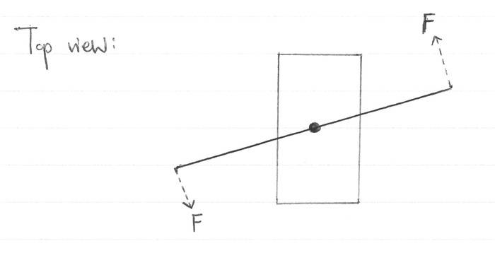

The direction of the torques in the following working will be found using: [itex]\vec{\tau} = \vec{r} \times \vec{F}[/itex].
When viewed from above, the counterclockwise rotation of the blades produces a torque out of the page:
As the angular momentum (right-hand corkscrew rule) is also out of the page, the body will begin to rotate clockwise to conserve the angular momentum.
The direction of the torque associated with this rotation of the body will be into the page:
Hence we have a torque into the page, and a torque out of the page. Q1) If these torques are in opposite directions, why are these not sufficient to cancel out the rotation and keep the body steady?

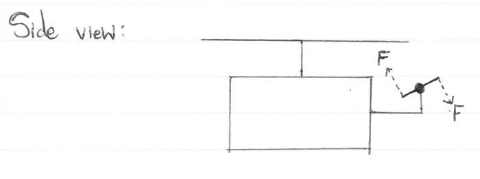

The tail rotor is added to do this job (as I have been told infinitely-many times). By considering a side view of the helicopter, and a tail rotor with a clockwise rotation, it will produce a torque that is out of the page in this view.

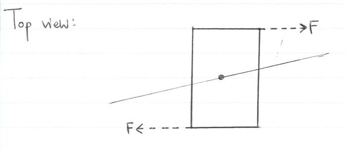

If the helicopter is re-considered from a birds-eye view, the tail rotor has produced a sideways torque. Hence the torque on the body due to the main rotor, and the torque of the tail rotor are perpendicular - how can they cancel one another out?

The torque around its own axis is not the only force acting on the helicopter from the rotors. There is also the upward force from the big rotor, you know, the one lifting the helicopter ... and the corresponding force from the small rotor, which is perpendicular to the rotor itself. This latter force is going to provide an additional torque about the axis of the big rotor.

These equal-opposite torques act on two different bodies: rotor and helicopter. If you treat rotor and helicopter as one body, this torques becomes internal, and the external torque is from the air (drag on the blades). This external torque by the air needs to be canceled by some other external forces, than those on the main rotor.
The tail rotor also produces a horizontal thrust force, which creates a vertical torque that cancels the vertical torque from the air on the main rotor.
The reaction torque from the trail rotor (that you show in the side view) is canceled by a combination of main rotor thrust force and gravity. The sideways thrust force of the tail rotor also has to be canceled by the main rotor thrust force to avoid sideways drift.
Your idea of two rotors canceling their axial torques directly, applies to counter rotating twin main rotor configurations, but not to the tail rotor configuration:

The part that solved my confusion, and that nowhere seems to emphasise adequately is that the torque that the tail rotor provides is about the axis of the big rotor. This is what I was missing. Thank you.
