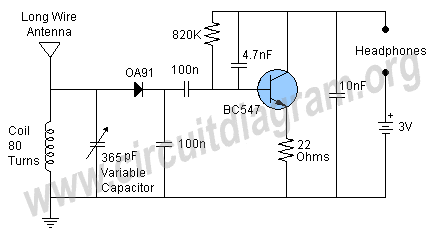

michael1978 said:
ok, so we leave regenerativ, for example if we want coupling L2 only main with vc resonant and coupling how to know how many turns?
The regenerative setup changes the sensitivity of the tuned circuit, therefore you need another schematic.
