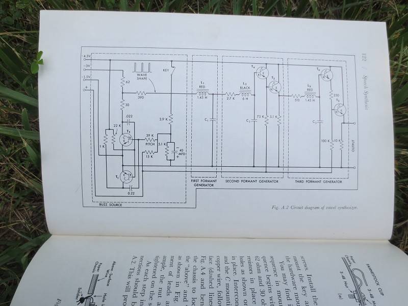

Yes it is. Back in the early 1960's at our little towns annual carnival, Bell Telephone Laboratories had a booth and I was given a Speech Synthesis kit. I still have the booklet. Here's some pictures from it:
WOW dlgoff this is AMAZING! Thanks a lot! And what an important piece of history you have with you! Sharing is caring, thank youuu :smile::smile::smile:
