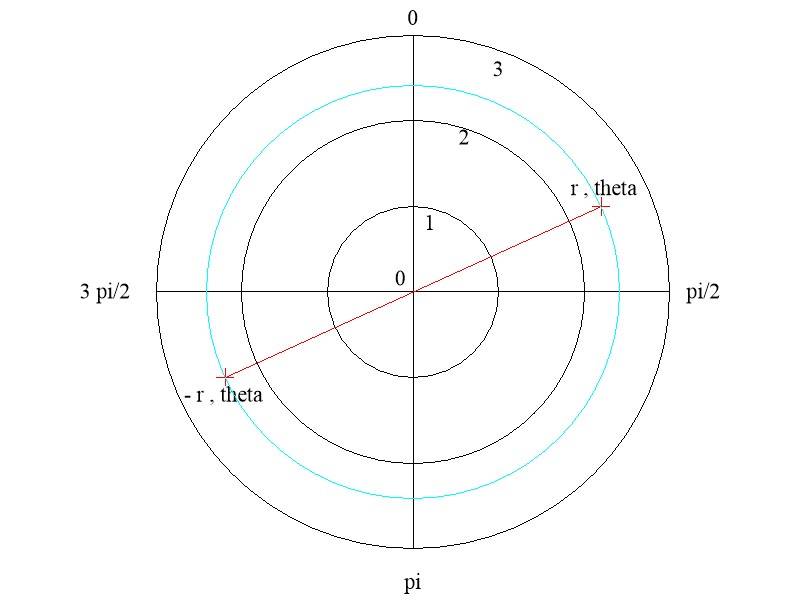

Here it is again :

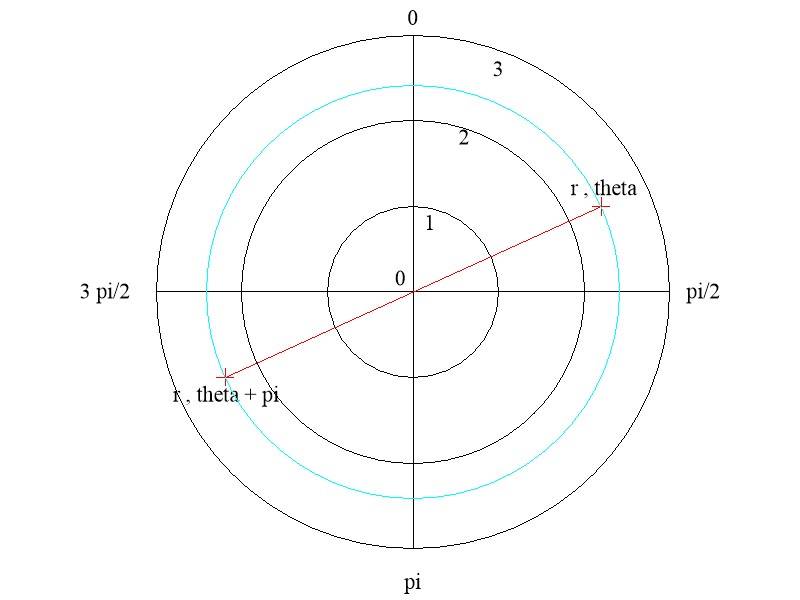

I think though that using ( r , theta + pi ) would be preferable to using ( - r , theta ) for the coordinates . It's difficult to visualise what - r means in polar coordinates .

It's really not that difficult to visualize. The ray in the first quadrant has r > 0. For a negative r with theta being the same, just go out the opposite direction as r is in. This works the same way as it does for vectors, where u and -u point in opposite directions.
