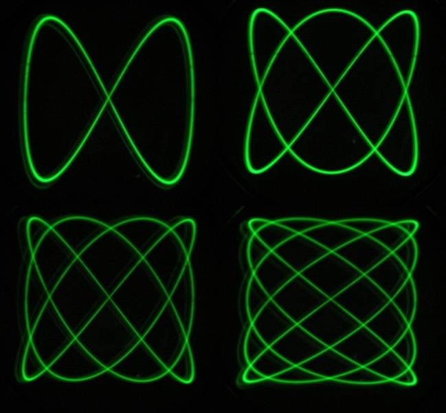

Another option for having a fun visual display with music is to drive the display in an x-y fashion. If you put a continuous sine wave (say at 60 Hz) on the horizontal axis, and drive the music waveform on the vertical axis, you can get some really fun and cool Lissajous patterns. I used to do this with an old oscilloscope and rock music back in college. It was a very popular display.
You could even adjust the frequency of your horizontal sine wave to give you the best patterns for the particular song that is being played. I don't know if the resolution of a 12x12 display is enough to get good patterns, though.
https://mbhs.edu/~jeglick/Images/TV/Lissajous%20Curves.jpg
A bit Offtopic, but ...
I set up a dual servo amplifier to drive the deflection coils of a TV. Equalized one channel's bass to get enough phase shift to look cool.
