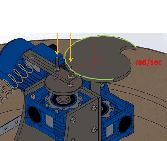

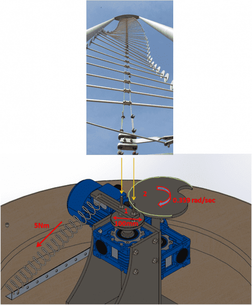

Hello Guys,
I'm building a vertical wave machine.
I have a big bearing [2] (more like an eccentric) which is rotating by an electric motor with a constant speed of 0.359 rad/sec.
When 3/4 of the bearing touches bearing [1] it supposed to rotate it a 1/4 turn, which as a result the ladder with the rods should rotate 1/4 turn.
Once they are not touching each other (passing the green diameter), bearing [1] returns to its place a
due to the spring resistance force and creates wave movement in the statue.
I know the following parameters:
In order to to remove the rods from equilibrium I need torque of 30 Nm.
The motor output is 110 Nm and it rotate bearing [2] in constant speed of 0.359 rad/sec.
The spring have resistance force of 10N
Diameter of bearing [1] is 100 mm.
I need help in calculating the green line = the contact line= the big diameter of bearing [2].
If necessary I will be happy to provide additional data and info.
Thanks to all helpers.

This is not a simple question because you must take into consideration how much time it will take to transfer the 1/4 turn base drive from the stack connection point to the top of the flexible assembly plus the time is required to allow the bottom of the stack to return to its next cycle start of rotation point, ie the stack's 1/4 turn windup +1/4 turn unwind total time. This will be controlled by the speed of rotation of the stack assembly during "bearing" contact and the spring factor and the inertia of the stack; and, could create some unusual and/or unanticipated stack oscillations and/or harmonics if this process is interrupted mid-cycle and can interact with the return spring as well. The natural frequency of the stack windup-unwind cycle and the natural frequency of the return spring must also be taken into consideration to insure that the drive will not match or closely match this frequency and potentially result in a catastrophic structural failure.
Hi JBA,
1. Thanks for taking the time to look at the problem.
2. Any suggestions for an approximate solution? I will maximum do minor repairs in the field...

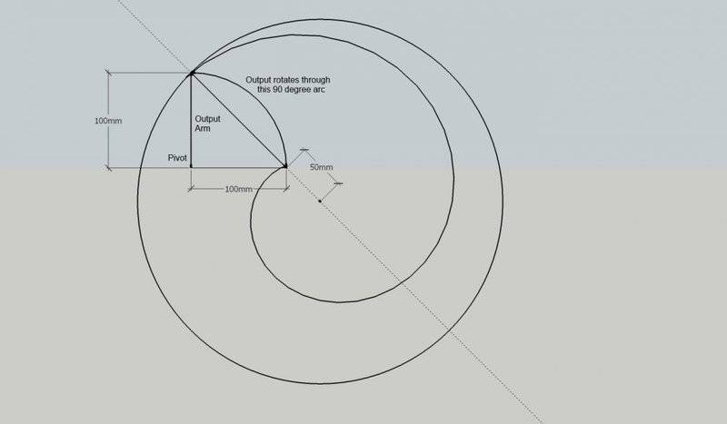

I can't add much except that the geometry looks way off...
The contact point between cam and 100mm roller appears to be roughly on the line between centre of the cam and centre of roller. So the cam will force the axels apart rather than causing the roller/arm to rotate.

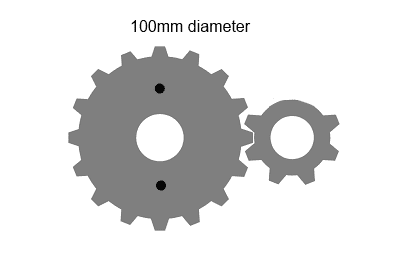

I'm no expert but perhaps one option might be to use circular gears with missing teeth instead of a cam arrangement?
How about something like this.
You asked for the 100mm output gear to rotate 90 degrees (1/4 turn) when the cam gear rotates 3/4 of a turn. Using gears with missing teeth the "cam" gear actually has to be smaller than the 100mm gear. If the small gear has 1/4 of the teeth missing then the remaining 3/4 have to rotate the large gear 1/4 revolution. I make the diameters of the small gear about 33mm.
The main problem I see is the possibility of the gears jamming if they don't re-mesh correctly. Perhaps there is a tooth profile that can avoid this? Wear and lubrication is harder?

Is the bearing/cam/eccentric direction of rotation shown as backward? Does all the energy that goes into the wave step all come from the spring? Is the wave supposed to be a saw-tooth wave?
I would have expected a small diameter roller mounted on the arm that followed the eccentric cam, with the return spring holding the roller onto the eccentric cam.
Hi, Baluncore
1. yes, the eccentric direction in the picture is wrong.
2. When bearing 1 rotates 1/4 turn so is the first rod. Once it is released, the spring brings it back, and the wave start. So yes it is possible to say that most of the energy that goes into the wave step come from the spring. (maybe even all, I don't sure).
3. no, the shape can be what ever, but of course some kind of circular pattern.
4. Diameter 1 must be bigger, becuese the motor output is 110 Nm, while in order to to remove the rods from equilibrium I need torque of 30 Nm.
* can I solve this using energy equations? if so how?

Ok so it's not to dissimilar to the gear with missing teeth approach.
3/4 of a revolution of the cam = 1/4 revolution of the output.
So the ratio of the diameters when driving must be ...3/4 : 1/4
or
1:3
So if the output is 100mm diameter the cam must be 33mm diameter over the 3/4 of its circumference when it's driving.
For the 1/4 of its circumference when it's not driving the diameter just needs to be sufficiently less that slipping occurs. Probably not critical. Depends how hard the rubber is.
The ratio 1:3 also increases the motor torque so if I've understood correctly the output torque available would be 300Nm which should be plenty (you only need about 40Nm?).
The output rotates at 1/3 the motor rpm when driven.

In this case wlll the following solution work?
both gears are the same size but one of them that connected to the motor is 3/4 cut off.
since the motor torque is more than I need, I shouldn't have problem or be concerned of it...

Probably. My concern with the "gear with missing teeth" approach is that they might jam if they don't re-mesh correctly.

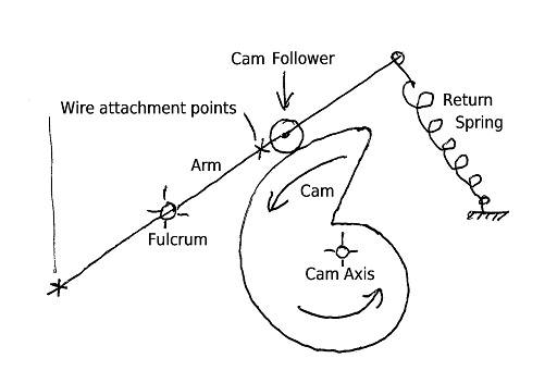

Let's approach this problem again.
I think the OP design has been used before somewhere and this is reverse engineering based on a poor picture or unreliable memory.
If we eliminate friction drive and rearrange the bits we have a motor with a reduction gearbox driving a cam.
A swing arm attaches to the two wires symmetrically above a fixed vertical axis bearing. A cam follower is mounted on the arm. A return spring is attached to the arm.
The cam follower mounted on the arm is a roller or wheel, the OP significantly calls it a “bearing”, running on the outside of the cam. It would not surprise me if the cam follower originally used was a standard deep groove ball bearing, bolted to the arm. The arm rotates through 90° and then falls back for each turn of the cam. The position of the cam axis, follower and arm fulcrum set the rotation angle.
There is one modification that I would make to reduce the stress. I would spring-load the cam follower on the arm so as to allow it to advance on the cam by half the follower diameter as it goes over the step on the cam. I would also consider using a polyurethane skateboard wheel as the follower as that would help silence the mechanism.
The speed of the repeat cycle is decided by the choice of motor speed and gearbox ratio. It could be adjusted if necessary with a VFD.

I agree that's a better approach but when I looked at that I couldn't immediately see how to get the full 90 degree output swing.
I know your drawing isn't to scale but if it was I think the cam has to overlap the fulcrum? Perhaps I didn't spend enough time playing with the geometry?
  • #35
Maybe.
I believe 90° is possible. There is no problem if the arm fulcrum is under part of the cam since the arm could be made from two flat bars, one above the other. When needed the cam could pass between the two arm bars for part of the cycle. The cam follower can also be mounted offset from the arm.
