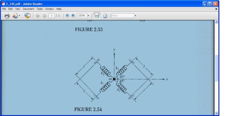

Help! Force of a Spring for "Small" displacements
Okay, here is the diagram,
For "small horizontal displacements" of the mass:
For the force exerted by each spring (TOTAL, not resolved) they are using:
Fsp=kxcos(45) and then resolving it onto the x-axis they use
Fsp x=kxcos25*cos45
I do not understanding this at all.
Why is the unresolved force using cos*45 ?
I am thinking it has to do with the fact that we are assuming that we are making
only "small horizontal displacements" of the mass.

The key word is horizontal as-in 'along the x-axis'. The springs exert a force in response to displacements along their lengths. What component of the horizontal displacement points along the length of each spring?
Well, apparently x*cos(45)...
But I have drawn it out like 4 times and cannot seem to see it. Guess you cannot really help me with that part though.
Well, let's look at the spring in the first quadrant: the angle between the horizontal displacement (call the displacement [itex]\dec{d}=x\hat{i}[/itex]), and the unit vector along th length of the spring (call it [itex]\hat{n}[/itex]) is 45 deg. To get the component of d along n you take the dot product of the two vectors, and [itex]\vec{d}\cdot\hat{n}=||\vec{d}||*||\hat{n}||\cos(45)=(x)*(1)\cos(45)[/itex]
Alternatively you can just use trig:
http://img19.imageshack.us/img19/1719/springa.th.jpg
Yes, I was using the wrong triangle like the jerk that I am. Thank you for that G... That offers a lot of insight into my problem-solving strategies.
