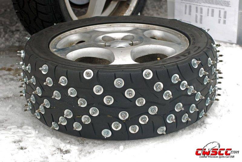

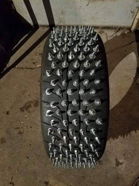

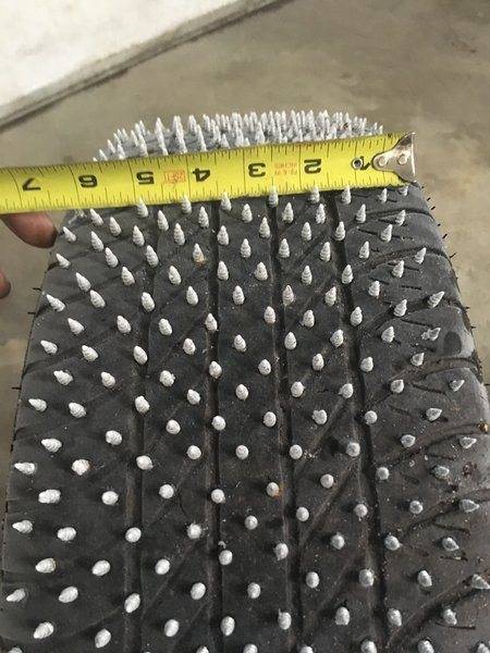

I have attached four Ice racing tires commonly used on cars and trucks. One of these is my own personal design that I have been racing with for a couple years now and still in the R/D stage but everyone keeps telling me my tire will destroy the ice we race on (think oval track) too fast and I find it completely hard to believe so now I'm asking all of you if I'm right or wrong so here we go.
#1 tire: The "menard" has been around for a long time and eventually will wear out the track by seasons end. Why? Because the studs are round and not a lot of them, also they will spin on the ice 2/1 ratio which kicks up a lot of snow dust.
#2 tire: Is my creation of wafer head #8 pointy tip screws sticking out 3/8" and is only 3/8" away from the next stud. Very sticky on glare ice and not so sticky on snow. My new design will incorporate a "new" snow tire so snow will escape the tire so the studs will hit the ice better.
#3 tire: This is the most used DIY stud tire and most people will sharpen the bolts with a snowmobile stud sharpener. This tire is all round good but I believe this will wear the ice fairly fast.

So the question is: Which tire would be the easiest on the ice (minor ice wear)?
I know there are a lot of other factors, Ice temp, car weight, HP and the list goes on... I get it. Try to answer the question as best as you can and maybe pick a tire you would use and why.
Thank you in advance.

As in other forms of racing – it comes down to tires, Tires, TIRES.Just like a tires contact patch on asphalt or dirt, your need max contact on ice.#1 tire has about 4 studs on across the tread face if you draw a straight line.
#2 tire has 10 studs
#3 has 5 studs

But this is not the whole story. Exactly how much contact patch do we really have.?So your design has a lot more studs when looking at it as straight line. But I recommend you calculate the singe stud area. Measure the height of the exposed screw . Next, you have to do a little math and calculate the exposed area. Lot of easy formulas for the area of a cone. I would not worry about trying to calculate the area of the actual screw as we just need a general number. Then count the total screws you stuck in the tire. Multiply the total number by your exposed “ stud area “ . This is the total you need to empirically define your tread design.Next , do the same drill with the other designs and see their area. I think the results will surprise you..and the know it all racers..The thing I find wrong in using the long studs for deep penetration is this has dubious merit. I don’t see the stud pushing into ice ¾ of an inch. If it did, your track would be skimmed down ¾’ a lap, right?
The other question is- what is optimum tire contact on the track surface for that time of day. I suspect ice surfaces change like dirt tracks do. Optimum tire studs used initially will be diminished as the surface wets up and ice churns to slurry conditions with a water film on top of the ice surface. So now we have to fight hydroplaning. This may be more ideal for the # 3 and # 4 design with not so radical depth studs.As a minimum, I can see at least two sets of tires per race. One with slicks and studs and one with snow tire treads ( rain tires would be better) and slightly deeper studs.
ps. do not worry about trying to convince the flat earthers, just get up on the wheel and drive it like you stole it..and win.
