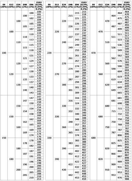

definitely a difficult oneit really boils down to what that very discoloured centre band was ??Here's a table showing all the different resistor ranges
the closest is 287 xOhms

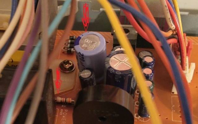

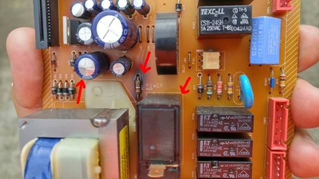

I just fixed my GE Microwave XL 1800 for $2.95. I purchased the 1/4W, 30k Ohm resistor and a 220uf 50V capacitor. Soldered them in, put the WB27X10438 control
board back into the unit and it works perfectly. The large black power relay is not manufactured anymore so I figured I would replace the capacitor and resistor, if that didn't work I would have to spring 150-160 for a new power control board.
Likes May Yen
If a ¼W resistor is overheating, I'd be tempted to replace it with a higher wattage, say, 1W, but keeping the same Ohms, providing the board can accommodate the bigger size and heavier gauge leads.
I will keep an eye on it from time to time, its very easy to get at and easy to remove. I did ask about it at the electronics shop and the older gentleman behind the counter said it should be fine. I did ask the same question about sizing. Other posts said that the resistor doesn't fail on its own its usually from another component failing. I spotted the ever so slight crowning on the top of the one capacitor so maybe that was the culprit. It would be nice so see the engineers schematic of the board that has the values for the components so when it comes time for a repair we know what we need to get. There are probably .001% of customers that will/can replace individual components on a board, so it wouldn't put a dent in the parts business. So far the microwave is working...
Electrolytic capacitors are about the most unreliable component there is. Most electronics repair guys learn that very quickly.
Electro's over ~ 5 years old are not to be trusted, whether ones in equip or just sitting on the shelf ... they dry out
and if they are in very warm conditions, eg a PSU, they dry out even faster
If you have ones that even look slightly suspect, just replace them ... they are cheap and it just isn't worth the hassle leaving them there and having them fail in the near futureDave
jcy110, I believe I have the same problem as you with the WB27X10438 board. What caused you to replace the 220uf 50V capacitor in addition to the resistor? All thread I've read (on this site and others) indicate the resistor as a source of the problem, but not the capacitor. thanks
  • #32
Sgib, as you can see in my pics on page 1, the cap is starting to bulge, that is why I replaced it. For a total of like 3.00 its worth the work.
