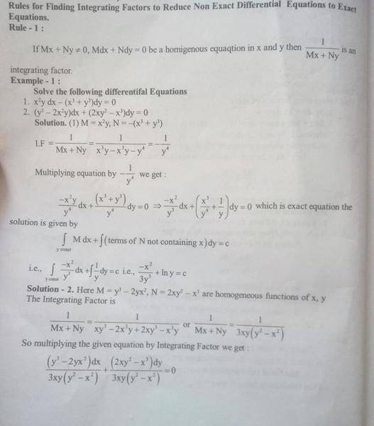

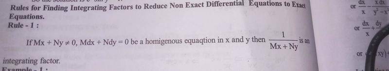

Here you can see the formula and I have done according to this.

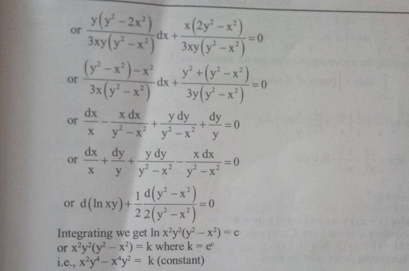

I see it is followed by an example. Would you post that too, please?
Here are they.

Hawkingo said:
Interesting...
What I see online is that the integrating factor being a function of x or y only are easy special cases. Indeed, they are the only examples I have found. I note also that the IF in the example satisfies the equation
