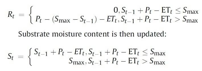

Hi guys I'm new to MATLAB but now i need to use it for my study. I've tried to learn by myself to run it but unfortunately it failed, so I need some guidance on how to run following time step function in MATLAB
St = St-1 + Pt - ETt, St-1 + Pt - ETt ≤ Smax
= Smax, St-1 + Pt - ETt > Smax
then
Rt = 0, St-1 + Pt - ETt ≤ Smax
= Pt - (Smax - St-1) - ETt, St-1 + Pt - ETt > Smax
Pt = rainfall depth
ETt = evapotranspiration rate
S = Retained rainwater depth in substrate
Smax = maximum retention capacity
R = runoff
it is a hourly time step function, hourly rainfall data for a year will be inserted to the function
i would be really appreciated if anyone could help me.

thank you for your kind response, maybe you can refer to the pic below & the function actually looks like this
i don't know how to explain the commas (sorry I'm not good in explaining things) , but its similar to simple function like this
Rt = (R1, R2, R3...) where R1, R2, R3 is the Rt calculated at every hour.
In this case, Smax = 16mm, Rt and St equations are different before and after it reach Smax

Ok. Here is something to get you started. I am at home and can't test this, so you will probably have to work on it to get it to run correctly. Also, you may have to change the indices of P and ET to get everything lined up correctly.
Code:
% find out how much data there is
[num_Pts, temp] = size(P);
% set initial values for t=1;
S(1) = 0;  % initial amount in the substrate
P(1) = 0;
ET(1) = 0;
% loop through the data and do the calculations
for t=(2:num_Pts)
   % calculate total  for time t as though there is no limit
   before_limiting = S(t-1) + P(t) - ET(t);
   % if the limit is not exceeded, it is all retained in S and there is no runoff R
   if before_limiting <= Smax
      S(t) = before_limiting;
      R(t) = 0;
   else
   % if the limit is exceeded, the max is retained in S and the rest is runoff
      S(t) = Smax;
      R(t) = before_limiting - Smax;
   end
end
