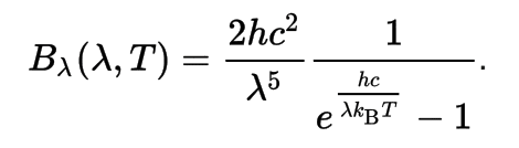

Steve4Physics said:
"E = σ/2εε₀" should be "E = σ/(2εᵣε₀)". The missing brackets alter the meaning. 12/4*3 = 9, but 12/(4*3) = 1.
It's pretty common to write ##\frac{ab}{cd}## as ##ab/cd##. In Young and Freedman, for example, the Planck law is written as
$$I(\lambda) = \frac{2\pi h c^2}{\lambda^5} \frac{1}{e^{hc/\lambda kT}-1}.$$ The five other textbooks I just checked also follow this convention. No one puts the denominator in parentheses.
Likes rude man
Before watching the video I had a go at the integrals myself. It is actually easier using polar (integrating the r coordinate first) than Cartesian. Yes, the range of r depends on theta, but it comes out easily enough using a change of variable like ##\sin(\theta)=\alpha\sin(\phi)##.
Then I watched the video and was blown away by the subtlety of the method. If the vector from an area element ##\vec {dA}## of charge to the point P is ##\vec r## then the field at P parallel to ##\vec {dA}## has magnitude ##k\sigma\frac{\vec r.\vec{dA}}{r^3}=k\sigma\frac{\cos(\theta)dA}{r^2}=k\sigma d\Omega##, where ##d\Omega## is the solid angle dA subtends at P. Brilliant. After that it is trivial.
Note that this can be applied to any uniformly charged lamina, though of course the field component parallel to the lamina will not always cancel.
Likes Steve4Physics
Yes, I'm know being pedantic!
ab/cd (all the characters on a single line) can be interpreted as as (ab/c)d or misinterpreted as ab/(cd) .
If we follow the conventional order of operations rule, we work left to right for a string of multiplications and divisions. We end up with (ab/c)d
For example, I have seen many students incorrectly calculate expressions of the form ##\frac{4\times 3}{2\times6}## (which obviously equals 1).
They have evaluated (entered into calculator) ##4\times 3 \div 2\times6## which gives 36. They should have entered ##4\times 3 \div (2\times6)##.
So my advice is; if writing a fraction on a single line and the denominator is the product of 2 or more items, put brackets around the denominator.
My point is that, based on common convention, (ab/c)d is the misinterpretation. If you write ##e^{ab/cd}##, physicists, mathematicians, engineers, and the like will not interpret that as ##e^{(ab/c)d}##. Sure, if you mindlessly apply the rules, you can argue it's the correct interpretation, but you'd just be tilting at windmills as most will not agree that that's what the expression actually means.
Hi. I agree that context usually prevents misinterpretaton (and avoids unaesthetic extra brackets). I know I'm being (very) pedantic.
I suspect the majority of physicists and engineers would agree with you. (Not sure about mathematicians who are often very fussy about these things!) But I prefer this (https://i.stack.imgur.com/3ugsV.png)
Also, I'm not sure that 'mindlessy' correctly applying rules is necessarily bad. As noted in post #23, I've seen too many students miscalulate expressions written in the (ambiguous) form ab/cd.
I guess we'll just have to agree to disagree.
