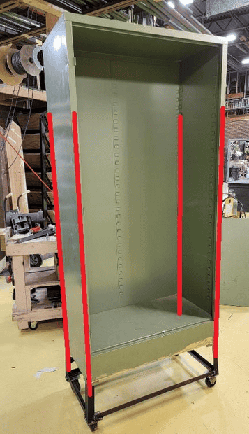

First, the cabinet in question:
The bottom is yet to be skinned, and obviously the doors are off. The whole thing will be insulated inside with a 1" rigid fiberglass board, and the outside will have 4" of rockwool or fiberglass batt insulation. I've drawn red lines in the corners which was my first idea - using four, 4' long IR halogen heating elements. The idea was to heat the part more than the air which should be more efficient as opposed to heating the very poorly-conducting air and relying on convection... which was my second idea. Using traditional household oven elements near the bottom of the sides to heat the air to convection-heat the parts.
My real thought here was that using a radiant heat source would be more efficient - that is to say, I could achieve my target curing temperature on the coated part with fewer BTUs or watts expended, but before I can start mathing out how much output I need, I need to know just how much (relatively speaking) the difference will be between convection vs radiation.

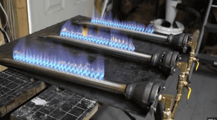

Traditional LPG grill burners (primarily convection):

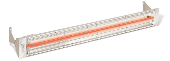

IR-emitting halogen elements (primarily radiant):

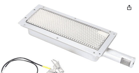

LPG catalyst radiant heaters (primarily radiant):
My real question is this: All of the above elements will produce both radiant and convective heat.... but in what ratios? Is the radiant halogen 90% radiant and 10% convecting, or 60/40? What about the oven element? I know it will offer some radiant energy, but how much?
The reason I need to know is because there is a requirement to pretty accurately control the heat of the entire piece being coated. I can't have one end reaching 450 degrees F while the other end is only 350.
My brain is telling me that I either need to do a whole bunch of smaller IR so I can bathe the whole part, or a few large hot things so I can heat the AIR to my temperature and (with the help of air circulation) make sure all of the air in contact with the part is doing the job of evenly heating. But I don't want to mess up and put a bunch of convective heaters in the bottom only to find out that their radiant heat is greater than anticipated and thereby scorching the bottom of the parts

Seems to me, your steel cabinet is not wll suited to this, being long in one dimension and quite short in another. You're asking for hot spots and cold spots. It means that you're going to need to use a bunch of smaller heat sources in there and it's going to be pretty awkward to get them all equidistant from the target.
That's all I got.

I agree. The main point of this cabinet was that I have a van roof rack that I want to coat. If I break it down into its smallest piece, it's still 68 inches. The cheapest quote for pro powdercoating I got was nearly $2400. The way I see it, I put $300 into this, coat the rack, maybe do a set of wheels, and I have what I want for a $2100 savings. Then maybe I coat a buddy's wheels in exchange for a case of root beer, and even if I throw the cabinet in a dumpster, I'm ahead two grand and a case of root beer. (Welcome to my mind)

I don't disagree. The primary purpose for this is that I want to coat a van roof rack. Broken down into its components, the longest pieces are 68" long, but only about 6" wide. The cheapest quote I got for pro powdercoating was nearly $2400 (which, ironically, exceeds the value of the van it goes on).
The way I see it is this: If I put $300 into this contraption and only coat this one roof rack, I'm $2100 ahead. Then if I coat some wheels later, and maybe do a set of a friend's wheels for a couple hundred bucks, I could throw this thing in the dumpster (I wouldn't) and I will have spent nothing but got the outcome I want. (yes, this is how my brain works)

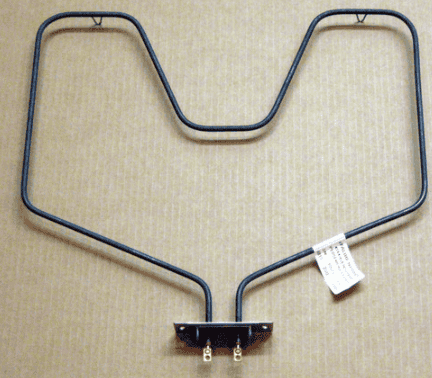

Ok, so given this feedback (thank you all so far), another idea popped into my head. What if I were to find oven elements that were straight and install them like the red lines in the first picture? Then it wouldn't really matter if the primary energy transfer were radiative or convective (provided I can move the air enough without disturbing the pre-cured powder.)
I haven't had any luck finding straight oven elements, but I should think I could find them somewhere.
Like this, but not bent to fit in an oven....
