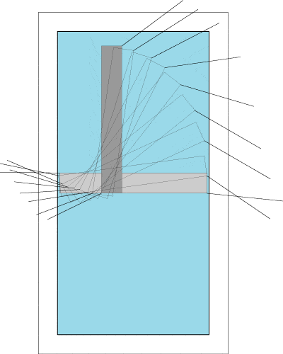

2 anchor points 2 boat hooks and 2 lengths of rope...38ft and 30ft, given the walkway round the pool is approx 6ft wide.
Attach a 10 yard length of rope to the bottom left of the bulkhead and 12.5 yards to top right of bulkhead
Push the bulkhead approx 7.5 yards towards the middle of the pool.
Follow diagram...
