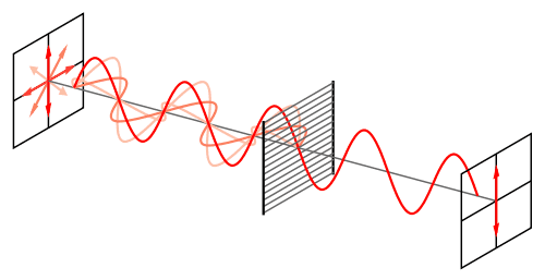

How does the SPOT detector decide whether a photon is vertically or horizontally polarized and how can it detect any of the vertically polarized photons if the SPOT is turned by 45 degrees?
There are different types of polarizers and simplest is the wire-grid polarizer consisting of an array of fine parallel metallic wires. All light that pass through will be polarized perpendicular to the wires.
Unpolarized light polarized vertical
