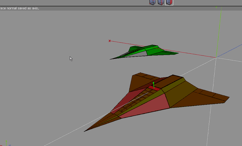

Wings 3d has a feature called rotate to target, you select a vertex, surface or line and chose the direction of rotation, based about that point and only that point. I have a hard time understanding the problem in detail though, but
1. you want the object to only rotate about the Z axis?
2. You want this rotation to be carried out on a certain point on the object?
3. You want to implement this in the in game world, which means you would need to know how to program this?
Usually when you do the standard rotate in wings 3d the software does it at the geometric centre of your object. If you want it to rotate at another point you have to chose.
