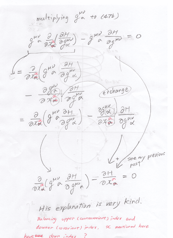

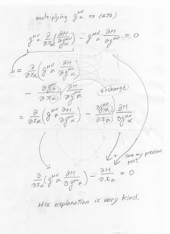

@Pyter Please investigate the attached calculation.
Likes Pyter

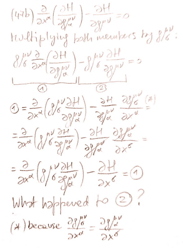

@anuttarasammyak my calculations are attached, as per the original paper. It's pretty straightforward, there's no need to derive ## \frac{\partial H}{\partial \sigma} ## .
@anuttarasammyak I see your point. You get the ## \frac{\partial H}{\partial \sigma} ## with the total derivative of H, but I get it by simply canceling out the ## \partial g^{\mu \nu}_{\alpha}## at the numerator and denominator.
@Pyter
Formula of H in (47a) shows
[tex]H =g \Gamma \Gamma=H(g^{\mu\nu},g^{\mu\nu}_\alpha)[/tex]
All the parameters should be considered for partial derivative calculation. See derivative formula in post #4. Both RHS terms are necessary to make ##\frac{\partial H}{\partial x_\sigma}## though you deals only the 2nd term. Einstein prepared the both.
@anuttarasammyak absolutely right. Now I see my error: given ## H = H \left( \xi^{\nu} \right)\text{, }\xi^{\nu} = \xi^{\nu} \left( x^{\sigma}\right) ##, I calculated:
$$ \frac {\partial H}{\partial \xi_1} \frac {\partial \xi_1}{\partial x^\sigma} = \frac {\partial H}{\partial x^\sigma}, $$
while it's in fact:
$$ \frac {\partial H}{\partial \xi_\nu} \frac {\partial \xi_\nu}{\partial x^\sigma} = \frac {\partial H}{\partial x^\sigma} .$$
I guess tensor calculus tricked me again. Well spotted.
