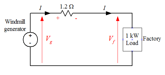

In summary, the factory owner needs 2km of copper wire of diameter 3mm to connect the turbine to the factory. The wire has a resistivity of 1.2 Ω. If the factory owner wants to use the transmission mode with 230V, they will lose 88 volts in the connecting wires. If the factory owner wants to use the transmission mode with 12V, they will lose 250 volts in the connecting wires.
Jamie Bristow
A small factory has decided to go Carbon neutral and has installed its own wind turbine. The wind turbine is installed on land belonging to the factory 1 km away. The factory owner needs 2km of copper wire of diameter 3mm to connect the turbine to the factory. The resistance of the cable is 1.2 Ω.
a) What is the resistivity of the wire?
The turbine generates 12V dc electricity and needs to supply the factory with 1kW of power. The factory owner has the choice inverting the supply to 230V or transmitting it at 12V. By calculating:
b) The current that passes along the cables if they are to deliver 1kW of power to the factory
c) The power that would be lost in the connecting wires
d) The total power that must be generated
e) The efficiency of the transmission
For both voltages decide which is a more efficient mode of transmission?
For: Resistivity
p= RA/L
I got 4.242x10^-9 ohmmeters to 4 s.f.
not sure how to implement the Power loss Formulas:
P = IV = I^2R = V^2/R
Would I use V=IR to find current and Voltage drop and the add to the power loss formulas or use I=p/v for current and use the initial voltages?
How do I go about finding the total power generated to deliver the 1KW of power to the destination? would it be a case of simple addition or is there a formula for this?
In order to deliver 1 kW of power to the factory, the factory end of the cable must have a combination of voltage and current such that ##I V = 1kW##.
The thing is, for any given current there will be a voltage drop along the cable due to its resistance. In the case of the 12 V source the factory won't see that 12 V, it'll see 12 V less whatever drop occurred on the cables. See if you can set up an equation that reflects this. Write an expression that will give you the voltage ##V_{end}## at the factory end given that some current ##I## is being drawn. Find the current that will make ##I V_{end} = 1 kW##. (Hint: it may not be possible!)

Here's a diagram we can work to:
Write KVL for the loop using ##V_g## and ##V_f## for the potentials at each end of the cable.
Consider how you might change or what you might do to the equation so that there will be a term for the factory power in it.

Going around the loop clockwise starting from the bottom left corner of the circuit:
Gain of Vg due to windmill generator
Drop across 1.2 Ohms
Drop of Vf across factory
Return to bottom left corner.
Write it as an expression.

You need to be able to write a KVL equation using the given voltages, component values (resistors) and current variables. That's a basic necessity.
There's only one current (unknown, variable: ##I##)
There's one resistor (known value: R = 1.2 Ω)
One voltage source (known value(s): ##V_g## = 12 V or 230 V)
One load voltage (unknown, variable: ##V_f##)
There is one constraint given: Load power is to be 1kW.

Multiply the resistance by ##I## and you've got it. Ohm's law: ##V = I R##. ##I## is the (as yet unknown) current passing through the resistor, so the (as yet unknown) potential drop across the resistor is ##I~1.2 Ω##. All the terms of an equation must have the same units. In this case, volts. So the lone resistance value kind of stuck out.
Now we don't yet know what the factory voltage ##V_f## is, nor do we know the current ##I## that it draws. However! We do know that the factory wants to use 1 kW of power. Power is given by ##I V##. So how might you modify your KVL equation to incorporate that constraint? Here's the equation in its current form:
##V_g - I R - V_f = 0##
Note the ##V_f## variable sitting there. It's an unknown...now if only it were the load power instead...

IVg - I2R - IVf = 0
They're all looking a lot like power equations now
Jamie Bristow said:
IVg - I2R - IVf = 0
Excellent. Note that each term represents a power, either generated or dissipated by one of the loads (the cable resistance counts as a load as far as the generator is concerned). You are given the desired factory load power, so you have a number to insert in place of that that ##I V_f## term. The only unknown left in the equation is the current ##I##. Solve for it.
The equation is quadratic in ##I## so you'll have the possibility of two solutions to choose from (imaginary solutions would rule out a physically realizable solution; note the results when you examine the solutions for the 12 V generator voltage).
What do you find?

Oh my. I didn't anticipate this.
So arranging for the quadratic formula I get
-1.2(I)2 + 12(I) - 1000 = 0
and
-1.2(I)2 + 230(I) - 1000 = 0
for 12V, the discriminant was a negative root, so 12V is impossible?
for 230V, i got that I could equal 4.45...A, and 187.215...A

Huzzah! Yes.
So the "12 V solution" that the factory owner dreamt about was purely wishful thinking. Can't be done with 12 V.
The two real solutions that turn up for the 230 V case bear some investigation. Why two realizable solutions? Plug the current values into the individual power terms in your equation and see if you can spot a problem with one of them.

Ahh, I think I see. With 4.45A, 1023W is generated, and 23W is lost in the wires.
and with 187A, 43,010W is being generated, with only 41962W being lost in the wires?
So 4.45A is the more sensible choice?
I think you get the picture :biggrin:
Now that you've identified the practical choice, you should have all the information required to complete the problem sections.
