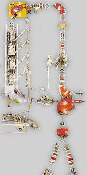

1) You can use a Van de Graaf generator as a particle accelerator, yes (that is, you collide a moving beam of particles and a stationary target. "Collider" normally implies two beams. I don't think it's impossible to use a Van de Graaf as a collider, but I don't think it has been done). Van de Graafs are still used in nuclear physics today.
The way it works is reasonably simple. As I'm sure you know, you can use a Van de Graaf to produce a large positive potential on the terminal. If you place the terminal in a pressure vessel, you can use something like Sulfur hexaflouride (SF6) as the insulator, and get very high positive potentials (25 MV was the record. Van de Graafs in operation today top out at about 15 MV). So, you've got a positive terminal. Then, you can introduce charged ions. Now, depending on the geometry of the accelerator, these may be positive or negative. If you place your source of ions in the terminal, then they need to be positive, and they will be repelled away from the terminal, giving you acceleration. Add a few magnets, and some focussing elements, and you have a rather nice accelerator.
Now, you can play a rather clever trick. Rather than placing the terminal at either end of the acceleration tube, you can place the terminal in the middle. Then, if you inject negative ions before the terminal, you get one stage of acceleration, and if you strip off some electrons (turning the ion into a positive ion) the ions will experience a second stage of acceleration! This more than doubles your bang for your buck. This is called a tandem accelerator, and many of the electrostatic accelerators used for nuclear physics research look like this. Here's a rather simple diagram showing the geometry (made by me).
https://dl.dropboxusercontent.com/u/34677838/14UD.png

Nice. Here's a fairly horrid top-down photo of one used for nuclear physics research. 6 MV/q, and fed by a 15MV tandem.
I like your example, nsaspook. Proof that accelerators come in all shapes and sizes!
