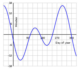

collinsmark said:
It will probably be within +/- 30 minutes from what your clock says noon is.
During summer time, some places in Europe have more than 1 hour difference.
Likes collinsmark
collinsmark said:
"local noon" in this context does not mean noon as displayed on your clock
Yes, I did point that out in post #3, but omitted to describe how to find it, working from scratch, as E would have done.

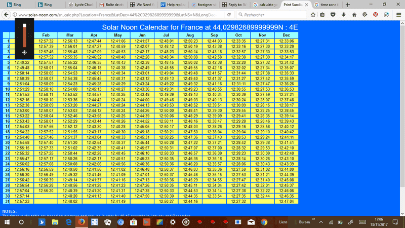

Thanks a lot for all the answers, we tried to understand them all We came to understand that the longitude is not usefull if we use the local noon. So here's our local noon. Please send yours and indicate us if you are interested in doing the experiment with us.
We do not need to know each others' local noons. In fact, you do not even need to know when your own local noon is according to the clock. As I wrote in post #10, you just need to take the shadow measurement when the sun as it its highest, i.e. when the shadow is shortest.
Using a published table to know when that is by the clock is a bit cheating. It depends how authentic you want to be.

Maybe this is a misunderstanding, but the time of the sun's culmination is the local noon. Or do I misuse the word?
In english the sun's maximum height above the local horizon ("local apparent noon") is called the zenith. The local time of local apparent noon varies with time of year due to a little problem known as "the equation of time". This variation is approximately 2/3 due to the Earth's tilt with respect to the solar plane and 1/3 due to the ellipsicity of its orbit around the sun. The following will give you an idea how local noon varies with local time over a year:
  • #34
BTW this is a good opportunity to remind any who need it or who lived in ignorance thus far that the roundness of the Earth was known WELL before Columbus! (about 1700 years before!)
