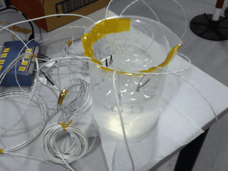

Muti said:
If possible a picture/ schemetic drawing of how all these "sensor" have been connected to the device. Did you connected the "sensors" to electronic device of it was already wired.
Shown below is an image of our ice-bath calibration - I need to redo the ice-bath however.
Unfortunately, we did not know to stir the solution. I am also assuming that it might be beneficial to wrap the jug in aluminium foil to reduce heat transfer.
I will upload a proper connection schematic once I get back to work. I connected the sensors; they were not pre-wired.

Very nice, but I want to remove all doubts about your hardware and software configuration. It is written on page 06 of manual that, "
With the OM-USB-5203, you can take measurements from four sensor categories:
 Thermocouple – types J, K, R, S, T, N, E, and B
 Resistance temperature detectors (RTDs) – 2, 3, or 4-wire measurements of 100 _ platinum RTDs
 Thermistors – 2, 3, or 4-wire measurements
 Semiconductor temperature sensors – LM36 or equivalent"
Now can you tell on which channel which sensor from above has been connected.
If you can not determine, then if this "setup" was provided to you pre-wired, then by back tracing wiring as illustrated from page 15 to 18 of manual you may be able to determine type of sensor connected to each channel.
I would be inclined to insulate the jar with bubble wrap and to get the sensors to the middle rather than the outside. I've a little electric milk frother (it looks a bit like a very small outboard motor) something like that would make a good circulating device.
