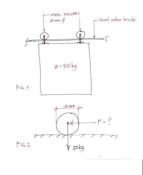

what is the required force to start moving a sliding door weighing 100 kg with two rollers.
what are the forces acting on the system?
shall i used rolling friction on this?
what formula to use?
thanks a lot.
tiny-tim said:Hi johnpaul! Welcome to PF!
There's no such thing as "rolling friction", since a pair of rolling surfaces don't move with respect to each other.
There's rolling resistance, which is essentially energy lost due to deformation of the wheel, but I shouldn't think three's much of that with steel.
The main problem will be friction between the wheel and the axle though its centre.
