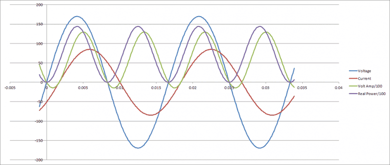

In summary, the spreadsheet attached plots inductive/resistive power in the time domain. The instantaneous power and volt amps are plotted. There are questions about the validity of the graphs and equations, and it is unclear how to attach the spreadsheet.
mdaugird
Please find attached a spreadsheet trying to plot an inductive/resistive circuit in the time domain and show instantaneous power and Volt Amperes.
Logic tells me power can not go negative, but I am not sure my power plot is correct.
Can someone please review the spreadsheet and chart to tell me if I am doing anything wrong?
I divided the VA and Power by 100 just to make the curves fit the graph. If my equations are correct i will address the formatting and second y-axis scale. How do I

Welcome to the PF.
If V(t) and I(t) are not in phase, then yes, there can be times when the instantaneous power goes negative.
how? I see VA going negative, but how can real power go negative?
When the sinusoidal current and voltage waveforms are in phase, they have the same sign during the whole cycle, so the product is always positive.
When they are out of phase, for part of each cycle they will have opposite signs, and hence their product will be negative.
But you can probably see that already from your graphs. Are you asking *physically* what is going on? Since positive real instantaneous power represents power being consumed by the load, what do you think negative instantaneous power represents...? :smile:
The graph shows real power always being positive, I was just surprised it was exactly in phase with the voltage.
The VA in the graph follows your logic but not real power.
Negative power from passive components would seem to be impossible and that is why I responded the way I did.
I might be mis-reading your responses but all of your responses seem to relate to the VA curve, and my questions are pointed at Real Power dissipated.
How are you calculating the graph of "real instantaneous power"? I could be wrong, but I believe that the real power is the time average of the instantaneous power. That's how you can have some negative values of the instantaneous power, but the average will still always be positive.
Instantaneous power V*I, has no real and imaginary components. Instantaneous power is real power. During one cycle without of phase V and I, it will become negative part of the time. If V and I are 180 degrees out of phase, it will be negative or zero the whole cycle.
If you are calculating instantaneous Real power as separate from volt-amps, then I don't know what calculations you are doing. Can you elaborate?

is what I am using for time domain real power and VA is just v(t) * i(t)
is the spreadsheet accessible at the link? I couldn't attach it.
So you are artificially calculating a waveform that would be the real power, if V & I were in-phase...
In real life, you don't have that. You have V(t) and I(t), from which you can get the instantaneous power waveform, and you can calculate Irms and Vrms over a cycle. Using those values, you can calculate the power factor PF = Average Real Power / (Vrms*Irms). The Average Real Power is the average of the instantaneous power waveform over one cycle.
https://en.wikipedia.org/wiki/Power_factor
From the Power Factor triangle, you can get the value of the "Real Power" and "Imaginary Power". Does that make more sense? :smile:

That formula in post 8 can not go negative. Where did it come from?
Anorlunda and Berkeman both nailed it. Study their comments.
You are making the wrong inference from what your results tell you.
The 'power' that you are seeing, represents the rate at which energy is being stored in and returned by the reactive components. At the end of each cycle, the net energy in the reactances is zero and so the net power 'dissipated' in them is zero.

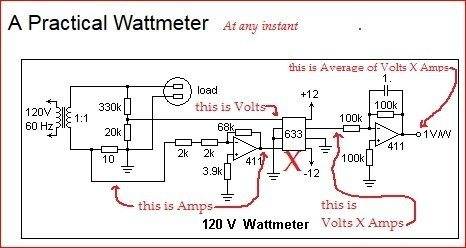

When it clicked for me was when i encountered my first electronic wattmeter. An analog multiplier IC does real time analog multiplication of instantaneous volts X instantaneous amps then averages the result.
this one uses the AD633 multiplier

so looking at the watt meeter, how does a commercial meter have a VA and KW reading that is different on an "instantaneous" basis.
it sounds like i need 1 cycle to average over to separate the 2 values.

so looking at the watt meter, how does a commercial meter have a VA and KW reading that is different on an "instantaneous" basis.

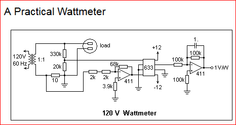

Let's take a look at a wattmeter.
The 330k and 20 k resistors divide tha 120V down to a manageable size signal for volts,
and the 10 ohm resistor gives a second signal that's proportional to current.
The 633 does an instant by instant multiplication of those two signals.
The rightmost opamp averages that product.

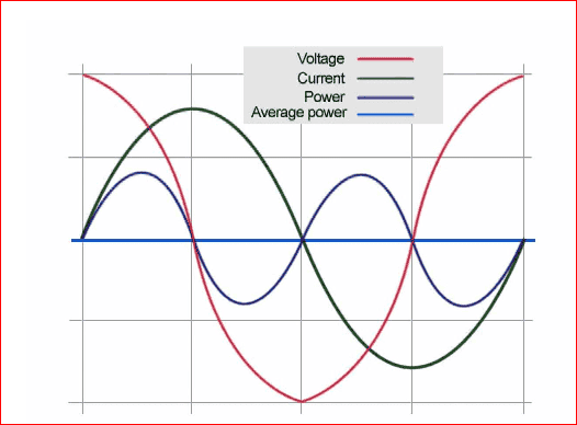

if volts = Vsin(ωt) and amps is Asin(ωt)
the product is VAsin2(ωt) = (1-cos(2ωt) ) /2 note double frequency
and notice that value is never negative , the math says so. I can believe that math ,even if only because volts and amps have same sign at every instant.
Okay, so just to make things interesting let's shift current by 90 degrees so it's all wattless reactive power
volts = Vsin(ωt) and amps is Acos(ωt)
the product is VAsin(ωt)cos(ωt) = ( VA sin(2ωt) ) / 2 , again note double frequency
and notice this time math says it's not offset so averages zero.
Intuitively, volts and amps have opposite signs half the time so the products will be half negative and half positive probably averaging zero.
Now let's take a look at the two inputs to the analog wattmeter for the second case
(mainly because i couldn't find waveforms for the first case)
here's the waveforms you'd see with an oscilloscope
what they call "power" is instantaneous volts X instantaneous amps, output of the multiplier, observe it's double frequency and has no offset
the straight line is averaged power signal.
