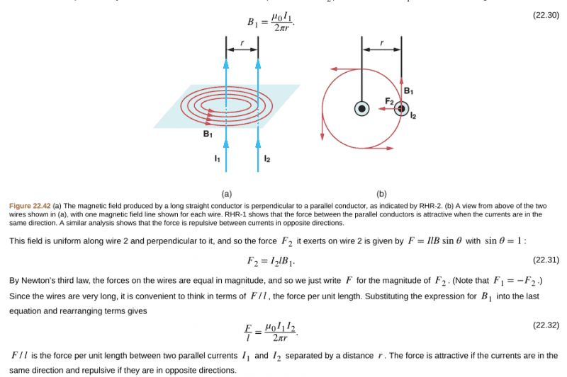

4. This question is not on electrostatics, but it is an application of magnetism – the force between two infinite current-carrying wires. (See attached image)
So what happened here is – the force due to wire 1 on wire 2 is calculated, and apparently that’s it – the force between the two wires is equal to that…. But shouldn’t the force be multiplied by 2 because of the force due to wire 2 on wire 1? Could I have an explanation as to why it is not necessary?

And 4.
You got it. From symmetry (turn over an angle ##\pi##), you see that the forces are equal and opposite. The text is actually very clear most of the time: the therm "force between the wires" is being used qualtitatively in the figure caption.
And I think you did indeed put your finger on a weak spot in the last line ! Instead of the vague term "between" they should have said "on each of the wires carrying the" .
Now go looking for an accompanying exercise at the end of the chapter and see if you nevertheless get the same answer they get :wink:--
