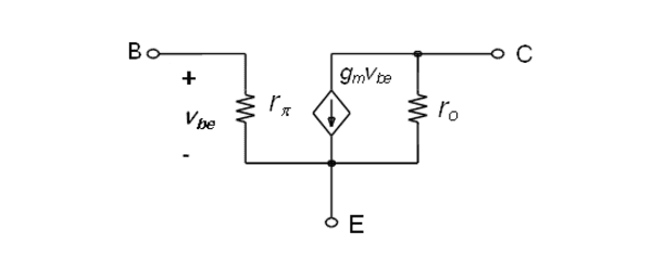

I need to know if my formula's are correct for current gain. Sorry for shakey drawing.
I know beta would change the dc values slightly but for my prof. it's close enough.
Beta AC = 70.

You're surely not trying to work through this exercise without sketching and labelling the circuit involving the transistor's small signal model, ARE YOU?!
The general expression for the current gain is Iout/Iin, where Iout is the current in the load, the load here being RL. The fact that you are using the terms Iout and Il for different currents when they normally are two names for the same current is just confusing.
The collector current is β.Ib and some of it goes through Rc and the remainder goes through RL. The small signal model shows this. You must always draw the small signal equivalent circuit to help with the AC analysis.

The simplified AC model of a BJT is known as the hybrid-Pi model.
rπ is what you know as β.re
gm.vbe is equivalent to β.ib
ro is ~100kΩ and can be ignored

Or the way I drew it. Still no closer to understanding how to calculate Iout though.
For your 100mV input, what will be ib? This allows you to calculate ic.
