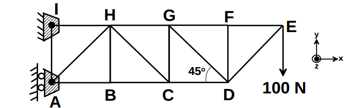

Help understanding how to determine Compress or Tension in Truss
What do you get for member CD?In summary, the conversation discusses a question on a past exam about determining tension and compression in a small square truss. The asker usually uses the method of joints but has trouble understanding how to solve the problem quickly. They ask for advice and the respondent suggests starting at the free end and working towards the wall, determining that members DE and EF are in compression and tension respectively. The conversation ends with the asker expressing gratitude for the help.
NoobeAtPhysics
75
A small square truss shown is supported by a pin joint at I and a roller at A. Label all members of the
truss by Z (for zero force member), C (for compression) or T (for tension).
So this was an exam question on a past test and I have troubles understanding how to calculate this in a fast manner.
I usually just use method of joints for each member and determine it that way. But I don't know how to determine tension/compression by looking at a truss. I've asked a couple people but I never understand what they mean...
What is your guy's approach/thought process when solving this problem?
My next exam is coming soon and I really hope to get a better understanding of this!
Thank you very much.
Start at the free end, point E, where the 100 N force is applied. What do you get for members DE and EF?
DE is compression and therefore EF is in tension
Good. Now work back towards the wall.
