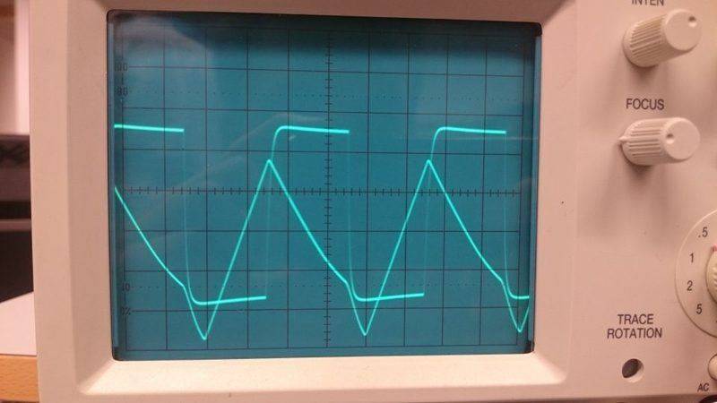

I need help understanding the frequency characteristics of operational amplifiers. I do not understand why the output of an Op-Amp behaves much differently when the frequency of the input is increased.
For example during the lab when the input to an inverting Op-Amp circuit was a sine wave.
At 1kHz it behaved as normal.
At 50kHz the output was not inverting anymore but triangular-like instead, as shown in the picture. Could anyone explain why the output behaves like this?
This is called slew rate limiting and is part of the OpAmp specification.
Ok thanks for your answer Svein. I have never heard of "slew rate" but I will look into it :D
Likes TonySimon
Slew rate is a large-signal parameter that describes the ability of the output voltage to follow the input voltage - indpendent on the gain (which is a small-signal parameter).
That means: When you drastically decrease the input (and, therefore also) the ouput voltage you should see that the triangle waveform returns to a sinusoidal form (when the peak amplitude is small eneough)
