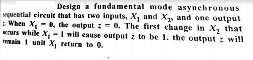

I am finding difficulty in understanding the sequence transition graph

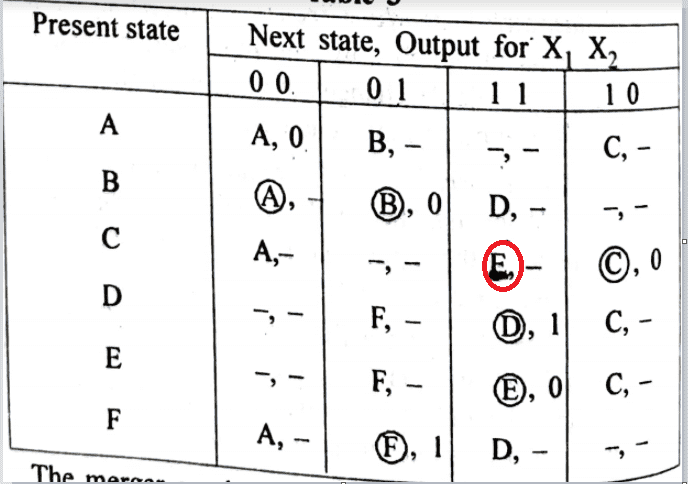

My Book has given solution like this
Question : I have marked red circle in the above table. ...book has given E but I think it should be F ...What is correct here E or F ?

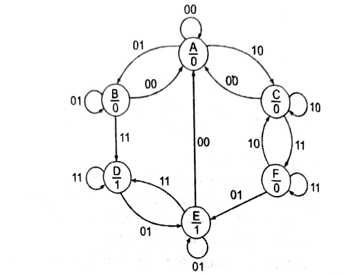

Here is the state diagram given in the book
I don't see how statement #2 can be simplified. It is a very straight-forward description of sequential behavior.
Perhaps you are confused because one can't do a simple truth table for states in sequential transitions. Those are for static circuits where sequencing doesn't enter into it. In this case you'll have to draw waveforms (squarewaves) showing the various possible states.

Yes, there are conflicts between the state diagram and the state transition table. It looks like they are for different problems?

I suspect that this is a printing mistake in state transition table. Can you please confirm this ?
my book shows E (red circle) in the table but I think it should be F ( as per the state diagram).
I am fine with the state transition diagram.
It seems book has printed mistakenly E ( instead of F) in the table... right ?

I suppose yes, but there are other discrepancies in addition to that. I'm not too motivated to find all of the errors. Frankly it is easier to just make the correct table from the diagram (or vice-versa) than it is to analyze how someone else did it wrong.
What I haven't done is match either the diagram or the table up to the words, I suspect that would be the best approach. You have three descriptions of the system, and I know two don't agree.
The table shows direct transitions C→E, D→C, E→C, F→A, and F→D. None of these are shown in the state diagram.
I guess "-,-" in the table means you are suppose to fill those in? Otherwise, I don't understand that notation.
