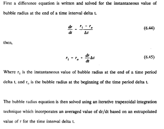

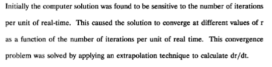

Trying to understand what is going on here, and how this technique removes the dependence of sample rate from the solution.
If you Taylor expand out the function in time, you get for time step h:
##r(t+h) = r(t) + h r'(t) + \frac{h^2}{2} r''(t) + \frac{h^3}{3!} r'''(t)...\\
r(t - h) = r(t) - h r'(t) + \frac{h^2}{2} r''(t) -\frac{h^3}{3!} r'''(t)... \\
r(t-2h) = r(t) - 2h r'(t) + \frac{4h^2}{2} r''(t) -\frac{8h^3}{3!} r'''(t)... ##
##3r(t) - 3r(t-h) + r(t-2h) = r(t) +h r'(t) + \frac{h^2}{2} r''(t) -\frac{5h^3}{6} r'''(t)... ##
So you can see this scheme is accurate to ##\mathcal{O}(h^3). ##
The benefit of this method is that it looks like an semi-implicit method, which should become stable regardless the sample rate. The accuracy will still be dependent on sample rate, but the stability is much improved compared to forward difference methods.

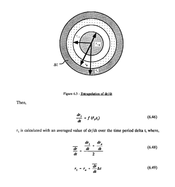

Would it be possible to plot the radius change over time in matlab? How would I go about doing that?
In the attachment, the equation marked (6.46) says
##\frac{dr_1}{dt} = f(\hat r _1, t_1).##
Do you know that function? If not, you can approximate the derivatives simply, but you lose some accuracy.Here is a rough code for the approximation:

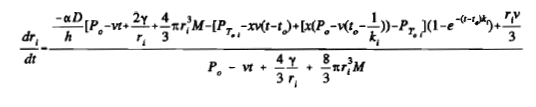

The function is the overall bubble size as it relates to a variety of factors (pressure, time, viscosity, tissue tension, etc) I am trying to understand how to plot the radius over time as pressure changes. From what you explained it seems that at each dt there is a pressure (which I can set based on my ascent or descent rate) that I can plug into the equation and get a new radius of bubble. Am I supposed to calculate the output of that equation using the extrapolation technique you just explained?

That seems to work, remember that you are using the approximation ##\hat r_1 ## to approximate the derivative, so plug that estimate (based on prior r data) into the formula for dr/dt.
Once you have that estimate for dr/dt, you apply the averaging and approximation in 6.48 and 6.49.
Assuming you know the previous time data ##r_{i-1},r_{i-2},r_{i-3}##:
1. Set dt timestep.
2. Set pressure rate.
3. Calculate approximation ##\hat r_i## based on previous r information.
4. Use formula with pressure and ##\hat r_i## or ## r_{i-1}## to get ##\frac{dr_i}{dt}## and ##\frac{dr_{i-1}}{dt}##
5. Use equation 6.48 to get average rate of change for the timestep.
6. Use equation 6.49 to approximate ##r_i##.

in this equation, how do I solve it to get the dr_i/dt and dr_i-1/dt so that I can plug them into the averaging formula? I know everything and all the constants but what is the MATLAB way to solve this?
If you know ##r_{i-1}##, you just plug it in. There is nothing to solve.
For the current (i) timestep, you don't know ##r_i##, so you use the ##\hat r_i## that you already computed.
