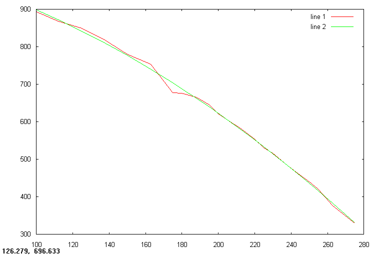

I am making a gauge using a microprocessor. I have several sensors and will post one now. It is basically a resistor and its value changes with temperature.
I connect this voltage to an ADC (analog to digital converter) that the micro can read and it returns a number between 1024 and zero that corresponds to the temperature.
I need a SIMPLE formula that will let me calculate the temperature based on the number I receive from the ADC.
The micro only does 16 bit math (no floating point) so it is very difficult to work with. It has normal arithmetic and a modulus (//) operator for the division remainder.
These are the numbers for the graph as I have accurately measured them. The formula needs to use the ADC value so I can calculate the temperature.
I will post the other two after this one.
Thanks for the help.

By far the easiest method is to just store a table of data points such as the one you have already measured and then do some kind of interpolation for intermediate points. Your data is close enough to linear that a simple linear interpolation between the given points will be very accurate.
Before you start however you might want to repeat your measurements a few times and take an average or something. If you plot your data points there are a few little kinks in it that might be measurement error. Overall the data looks like it could be approximated fairly well with a parobola if you wanted to fit a smooth curve to it and iron out the kinks.
BTW. Here is a graph of your data showing a "best fit" parabola.

Wow! -- funky. If it were not for the last three points (75-85 psi), I can get a good linear transformation via Y = a / (b - X)^p. However, "p" will be close to .25 and we would be stuck with computing a couple of square roots or a 4th roots (can be done with extra code and execution time - yuck). Could split the fit into two parts? (yuck)
I'll construct the polynomial fits (Linear, quadratic, and cubic), but the quadratic and cubic maybe difficult to compute on the Picaxe due to the math limitations - let's see.
OK – I ran some polynomial regressions on the latest data. I stuck to the polynomial models as they at least have a chance of being computed with the PicAxe math. Other exotic models would not likely be supported with the restrictions of integer math.
The regressions were not hard at all, but formulating the integer math sequences to emulate the real math took some time. I’ll present the real math results for the three polynomial models of order 1 (linear), 2 (quadratic), and 3 (cubic). I’ll then provide a suggestion for implemented the order 2 case with integer math.
Before performing the regression, I transformed the X variable (ADC) by its approximate median (475). That is, I let u = (x – 475) and regressed on y and u. The reason I did this will be clear in a moment.
Linear
Ao = 3.48892E+01
A1 = 1.86827E-01
R^2 = 9.10947E-01
StdErr = 7.35307E+00
Quadractic
Ao = 2.72311E+01
A1 = 1.67220E-01
A2 = 4.87571E-04
R^2 = 9.82796E-01
StdErr = 3.35387E+00
Cubic
Ao = 2.82827E+01
A1 = 1.17918E-01
A2 = 4.37581E-04
A3 = 1.77526E-06
R^2 = 9.92472E-01
StdErr = 2.30916E+00
Discussion:
Real Math Regressions:
The results of the linear case is less than desirable. The average magnitude of the residuals is 5.7 as the large standard error suggests. Percent fit is roughly 91%.
The results of the quadratic case is a little better as the R^2 value and standard error suggest. I explored this model as it had a fair chance of being handled with the Picaxe math and it was not an overly complicated case. By the time I’m done, the average magnitude of the residuals will be 2.3 and the standard error will be about 3.06 – pretty close to the real math case.
The results of the cubic case are better still, but I won’t pursue this at this time as it is difficult to model with the Picaxe math.
Picaxe suggestion.
As I said, if the linear case is still not desirable, then I suggest the quadratic case. This is a compromise as better models may exist, but they tend to be too exotic for the simple math engine of the Picaxe. With that, consider this scheme:
Code:
STEP ZERO – scale up integer representation of the coefficients.
Let K = 2^8 = 256
ao = Ao * K = 6971
a1 = A1 * K^2 = 10,959
a2 = A2 * K^2 = 32
Now consider the model depending on the value of X
Code:
If (X > 475) Then
   u = x – 475
   y = a0 + u * ( a1 + u * a2 )
Else
   u = 475 – x
   y = a0 - u * ( a1 - u * a2 )
End If
The following steps can now be used. For now, consider the case for X > 475. "Code comments" are after the semi-colon.
Code:
STEP 1 – compute a2 * u
   AX1 = a2 * u         ; AX1 = (A2*2^16) * u
STEP 2 – Add a1
   AX2 = AX1 + a1      ; AX2 = (A2*2^16) * u + (A1*2^16)
STEP 3 – scale down slightly (by factor 2^6)
   AX3 = [AX2 / 2^6]  ; AX3 = (A2*2^10) * u + (A1*2^10)
STEP 4 – multiply by u
   AX4 = AX3 * u
STEP 5 – scale down remainder of decade (factor of 2^2)
   AX5 = [AX4 / 2^2]  ; AX5 = ((A2*2^8) * u + (A1*2^8)) * u
STEP 6 – add a0
   AX6 = AX5 + a0      ; AX6 = ((A2*2^8) * u + (A1*2^8)) * u + (A1*2^8)
STEP 7 – compute Yp by scaling down AX6
   Yp = [AX6 / 2^8]
FINISHED
Of course, the variables (ie, AX1, AX2, etc) can be re-used and we don’t need separate ones for each step. I only did this for clarity.
When X < 475, compute u = 475 – x, and two of the above steps need to be modified.
Code:
STEP 2 – SUBTRACT AX1 from a1
   AX2 = a1 - AX1   ; AX2 = (A1*2^16) - (A2*2^16) * u
STEP 5 – SUBTRACT AX5 from a0
   AX6 = a0 - AX5   ; AX6 = (A1*2^8) – u * ((A1*2^8) - (A2*2^8) * u)
All the remaining steps stay the same.
These series of steps, as convoluted as they may seem, are necessary so that all integer math stays positive and within range of a 16 bit register. The end result of this approach yields the following fit:
Code:

As mentioned in an earlier post, the endpoints for high X,Y are showing a high residuals. You may want to treat the top three points as a separate case (with addition data within these points).
Its too bad that the Picaxe math does not support at least a Carry flag indication for under/over flow math operations and mult-word operations. We could do much more if we had at least that much.
Anyways, hope this helps.
