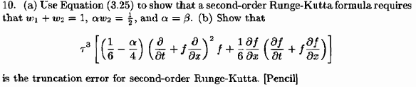

So here's my homework question:

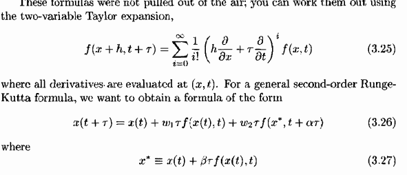

This is the reference formula along with the Rung-Kutta form with the variables mentioned in the question

What does eq 3.25 have to do with it? and i have no idea how to expand either of those
