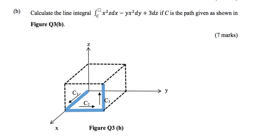

Hi all,
I'm finding it difficult to start this line integral problem.
I have watched a lot of videos regarding line integrals but none have 3 line segments in 3D.
If someone can please point me in the right direction, it would help a lot.
I've put down the following in my workings:
C1: (0,0,0) - (1,0,0)
C2: (1,0,0) - (1,1,0)
C3: (1,1,0) - (1,1,1,1)
How do I proceed from here?
Thank you in advance!

On ##C_1## dz=dy=0, so only ##\int dz## survives.
On ##C_2## and ##C_3##, similarly you should make one integral out of the three.

Okay, so i form three integrals and combine them?
Also that's where i am confused, when i am doing C1 shouldn't the 3dz go away too as its treated as a constant?
(correction) only ##\int dx## survives.
So for ##C_1## the integral is ##\int_{C_1} x^2z \ dx## where z is ...
Likes SK97
So for C1 i have the parametrisation as r(t) = <t,0,0>
I got this by doing:
x= t(1) + (1-t)(0) = t
and zeros for the others.
Is this the correct way to evaluate it?
So the integrand ##x^2z## on ##C_1## is ...
just t^2 dx right?
[tex]\int x^2z \ dx = z\int x^2 dx =..[/tex]
so replacing x with t we get t^2 in the integral but since z= 0 do we get 0 for c1?
sorry if I'm understanding incorrectly
:thumbup:
:thumbup:
oh thank you so much, so similar set up then for the other integrals and then at the end its just addition of them all, correct?
:smile:
Likes SK97
:smile:
Thanks a lot! hopefully i don't run into other issues but please be around to help out!
will greatly appreciate it :)
so i finished calculating for all C values and after the addition got to 7/2 as the answer.
does that seem right to you?
Seperate it into the sum of 3 intgrals over c1 c2 and c3. Then parametrize each path. Plug everything in, calculate dx dy and dz in Terms of dt, calculate the 3 integrals then. Add them, and you are done.
