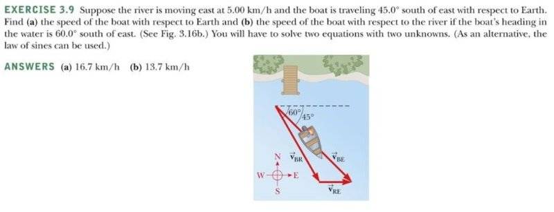

I attached an image with problem and the associated illustration.
I don't know what the relevant equations are for this problem.
Each and every time I read the problem I keep drawing a right triangle to represent the velocity components. The problem says the river is flowing east at 5km/h. I am assuming this is the x-component named Vre. It then says the boat is traveling south of eat at 45deg. I am assuming this is the vector with an unknown magnitude, named Vbe. The boat's velocity, with respect to the river(Vbr), is also unknown. In the previous similar problems Vbr was 10km/h and I can't help but assume it's the same for this problem. Also, vBR was perpendicular to the river, but somehow I feel like it's not, for this problem.
I don't know and I am literally ready to just give up and move on because I just don't have time for this.
Likes Hoophy

I was very fortunate to find the very pages on the internet. I'm doing Exercise #39 on page 73. I did Example 3.9 and 3.8(Page 71) without any issues, but Exercise 3.9 completely escapes me.
Do you mean lines 3.9 on page 73? Can you upload a PDF or JPEG snapshot of the part of the problem that is confusing you? That will work a lot better than us all opening your full text and trying to zoom in and decode which part you are asking about. Thanks.
(Click the Upload button at the lower right of the Edit window, or just use the Windows Snapshot tool to grab a copy of the problem, and Cntrl-V Paste it into the Edit window).

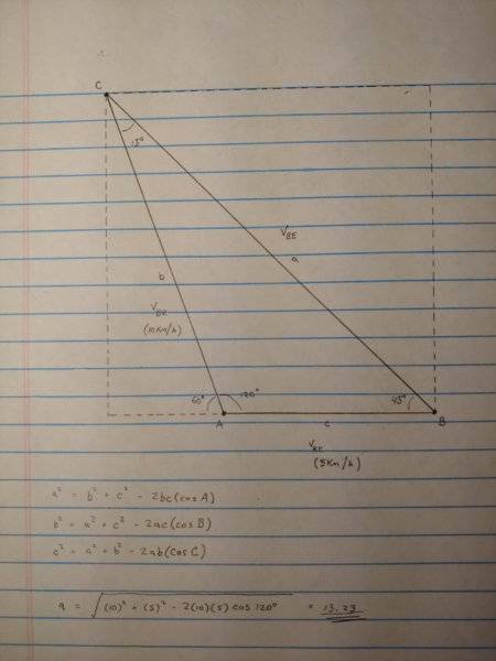

I give up. I tried the law of cosines and still got it wrong. I didn't even want to use the law of cosines. I wanted to solve it without using LOC. I'm super frustrated. I need to walk away from this. I really need to move on to new stuff. I'm already behind.

In your diagram, the dashed line perimeter is a square. Let its sides be h.
Can you get an expression for the known length AB in terms of h?

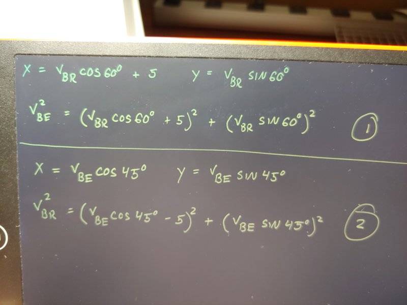

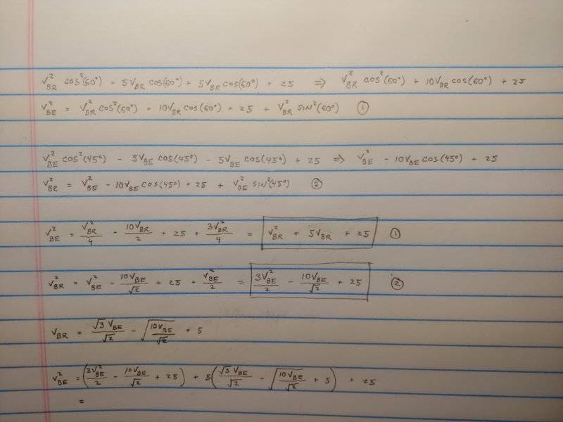

This is my best effort. I had a little more help from another forum but don't fully understand how that person got what they got. I just done get it.
In the 17a image, look at the two x= and two y= equations. Sin(45)=cos(45), right? What does that tell you about x and y? What do you get if you use that in the other two?

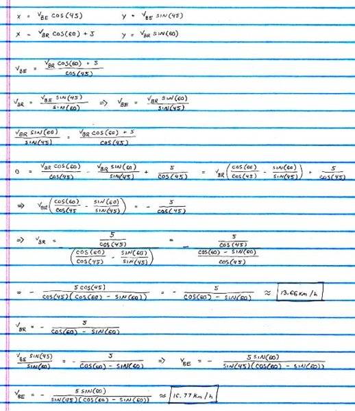

Finally! Oh my god! I'm suppose to know how to do this! Sad. Firstly, I remember solving for two unknowns in Algebra. It came back to me when I read what haruspex said.
The next mistake I made was that I didnt make each expression equal to each other. I was substituting one inside the other.
I can't tell you how happy I am to have figured this out. I have trouble not finishing stuff. If I gave up that woupd of really bothered me.
Likes berkeman
