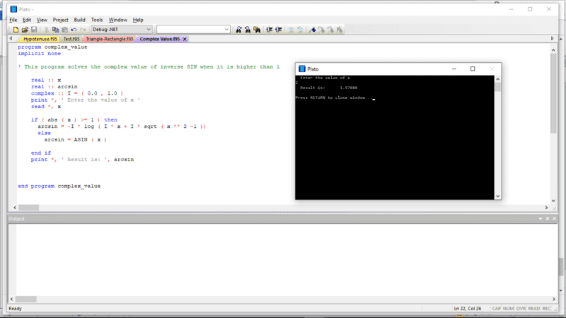

Well, I have another problem here, no matter what number I do assign to X the result is the same, something is wrong, here the complete code:
Code:
program complex_value
implicit none
! This program solves the complex value of inverse SIN when it is higher than 1
    real :: x
    real :: arcsin
    complex :: I = ( 0.0 , 1.0 )
    print *, ' Enter the value of x '
    read *, x
    if ( abs ( x ) >= 1 ) then
      arcsin = -I * log ( I * x + I * sqrt ( x ** 2 -1 ))
      else
        arcsin = ASIN ( x )
      end if
    print *, ' Result is: ', arcsin
end program complex_value
Whatever I do the result is the same:
The screenshot is too small for me to read. Did you enter a number > 1? If so, your code is incorrect, since in that case, your variable arcsin will need to be complex.
Fortran:
real :: arcsin
To deal with complex numbers you need a different variable for values of x > 1. Note that if x == 1.0, there's no problem, so your if condition should be if ( abs(x) > 1.0) then ...

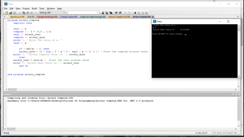

Well, I think I have solved the program:
I am testing it with an online chart and it seems that is now properly working, Thanks!
