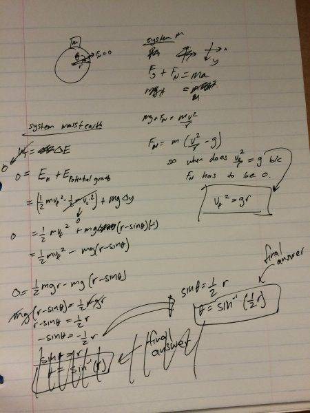

A point mass m starts from rest and slides down the surface of a frictionless solid sphere of radius r. Find the angle at which the mass flies off the sphere.
w=delta energy
Gravitaional potential energy = mgh
Kinetic energy = 1/2mvf^2 - 1/2mvi^2[/B]
is my answer correct?
Please check my picture
[/B]
I don't think that 'r' can be in the answer since the object of the inverse sine must be from 0 to 1.
So do u know where I am going wrong?
Oh I think I figured it out
Please do not post working as an image. It makes it hard to draw your attention to a particular line it.
Your centripetal acceleration calculation doesn't seem to take into account the directions of the forces. It is not in the same direction as g.

yes... the correct equation shoudl be
[tex] r-rsin(\theta) [/tex]
correct? and the rest of the problem should be correct?

No, there's still the problem with your centripetal acceleration equation, as mentioned. Which direction is that in? How does that compare with the direction of g?
I find it helpful to look at limits. What centripetal acceleration is needed at theta=90?...at theta=0?
You should be able to solve the problem with two unknowns: v and θ, and two equations: one from the centripetal motion constraint and one from conservation of mechanical energy. It looks like you need to make you problem solving process more clear and organized.

so is
[tex]a_c=\frac{mv^2}{r}+gcos(\theta)[/tex]
ok, I am not really sure how to find the acceleration. can anyone give me a hint on how to solve this problem?
When the weight flies off, the centripetal acceleration (v^2/r) must equal the acceleration of gravity normal to the surface (g sin(theta)).

ok by what is the acceleration of the block. In other words... for:
[tex]F_T-F_g=ma[/tex]
what is a?
a = v2/r = gcosθ. gcosθ is the largest centripetal force, component of gravity normal to the sphere surface. If θ is larger v will be too big to maintain in circular motion. Then use conservation of mechanical energy to obtain a second equation for v and θ.

There's no friction, and at the point of leaving the surface there's no normal force, so the only force is mg. But that does not mean g equals the centripetal acceleration. The mass can have both tangential and radial acceleration. We don't care what the tangential acceleration is. We need to extract the radial component of g and equate that to the centripetal acceleration..

This looks like you're measuring theta from the vertical. I believe OP is measuring it from the horizontal.
ok so measuring theta from the horizonta... isn't [tex] a_c = \frac{v^2}{r} + gsin(\theta) [/tex] or does the gravitational force cause the centripial acceleraion in which
[tex] a_c = \frac{v^2}{r} = gsin(\theta) [/tex] ?

Centripetal force is a resultant force, not an applied force. It is the radial component of the sum of all applied forces.

alright, so i split up gravity into tangental and radial components. at any point on the sphere, theta above the horizontal, the radial acceleration is Fgsin(theta) and the tangential acceleration is Fgcos(theta) correct?
Right, assuming Fg means force due to gravity (Fg).

yes, so centripital acceleration would just be the sum Fgcos(theta) and Fg(sing theta)? if so, where does the v^2/R factor in?
First, a small correction: those are forces, not accelerations.
Now a bigger correction: the (vector) sum of Fgcos(theta) and Fg(sin theta) is the total applied force.
The centripetal acceleration is the radial component of the total acceleration.
Combine those facts with what you posted earlier:
bearing in mind that that should read: the radial acceleration is Fgsin(theta)/m

alright so the radial acceleration would be...: the sum of vector Fgcos(tehta)/m + vector Fgsin(tehta)/m ??
but then it owuldnt even point to the center.
No, the radial component of acceleration results from the radial component of force. Only one of those is the radial component.

ok so the radial acceleration is the vector gcos(theta) ?
  • #31
If theta is still wrt the horizontal, no. At the top of the loop, the radial direction will be vertical.

oh sorry. i meant gsin(theta). but how does this factor in with v^2/r?
  • #33
You've established that the radial acceleration is g sin(theta). What does the radial acceleration need to be to stay in contact with the curved surface? What relationship do you think that leads to?

it has to equal the weight of the mass?
  • #35
A weight is a force, not an acceleration.
Let me ask you something - what do you think centripetal acceleration means? How would you define it?
