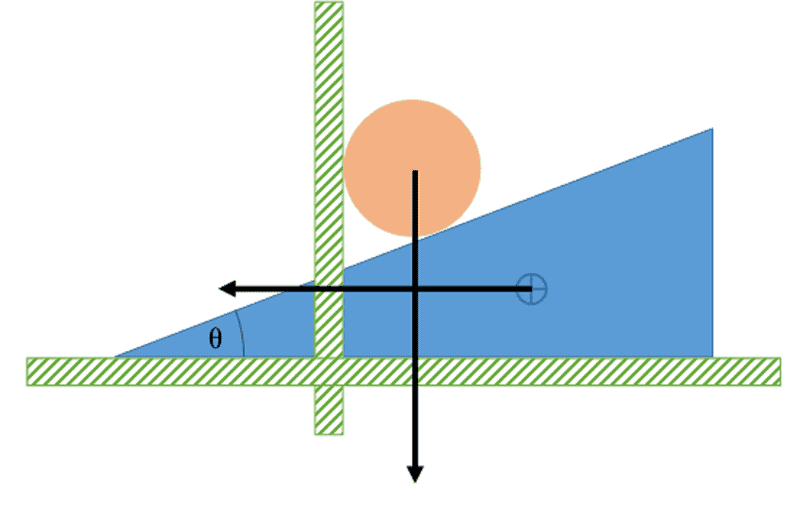

I'm designing an adaptor for a drinks optic and have translated one of the aspects of the design into the following problem. There is plenty of stuff on the net about simple inclined plane problems but not quite like this.
In this problem the blue wedge can only move horizontally, constrained by the fixed green floor. The orange pin (viewed here end on) can only move vertically. It doesn't roll and is constrained by the fixed green wall.
The idea of this mechanism (if you haven't already guessed) is that the pin is raised by pushing the wedge under it.
The pin is pressed down by force Fdown.
The wedge is moved horizontally by Fmove.
Ignore gravity.
I need to determine the angle theta in terms of Fdown, μa & μb at the threshold of moving.

At threshold of moving Fmove = Fdown.
ΣFx = ΣFy = 0
μwall-pin = μpin-wedge = μa.
μwedge-floor = μb.

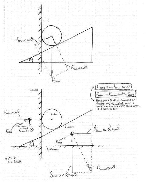

Here's where I've got to. I've got as far as balancing the pin, then the wedge, and now I'm considering how the friction & perp forces between wall and pin should be accounted for.

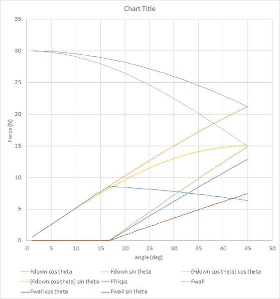

I've used a friction coefficient of 0.3, which has resulted in the "slip" beginning at ~17deg. When that happens, the wall begins to react some of the force, which also sets up a new perp and associated friction force between the wall and pin. I suppose that any perp force that cannot be reacted by the friction force will have to be reacted by the ground, which is in addition to the vertical force that is already present.
Must admit to being surprised at having created a problem which it appears that nobody has tackled before. As I say I can find nothing on the net. Even if I modify the question to say something like find what value of Fmove is required to move the pin upwards, in terms of theta and the friction coefficients, there is still nothing out there that I can find.

Ok, but then you should have written |Fmove | =|Fdown |, and it should have been as part of the problem description. "Relevant equations" is for standard equations, such as conservation laws.
You need to introduce unknowns for the three normal forces. You do not know in advance what these are. They're not simply components of the force needed to balance gravity. I would suggest not assuming |Fmove | =|Fdown | yet - you can plug that in at the end.
On the roller, you have six forces: gravity, the propulsive force, two normal forces and two frictional forces. Write out two equations containing them.
Likewise the wedge, with its five forces.
Since either nothing moves or sliding occurs at all surfaces, you can take the frictional forces to be at maximum everywhere.
That gives you four equations and four unknowns: the three normal forces and theta. Solve.
