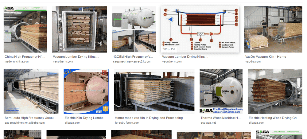

Take a look at GOOGLE IMAGES with a search term "Vacuum Drying Lumber". I found that they use designs along the lines I described above. They look pretty expensive - which is why you want to make your own, I imagine. But they are expensive for a good reason. You would never get employer's insurance for equipment like this that isn't certificated.

It would take a lot of dry timber to pay for itself, judging from those Google Images.
Thread closed temporarily for a Google Images search...

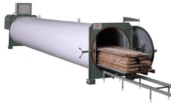

Vacuum driers for small to medium sized carpenter’s workshops
The ISVE EM2V vacuum drier has been designed and manufactured especially for small to medium sized carpenter’s workshops, with small quantities of wood to be dried, but requiring high quality and short drying times.
From, http://www.isve.com/en/vacuum-dry-kilns-model-em2v
Description
  • High frequency heating.A new technology totally different from the traditional conductive heating.Heating wood from inside to outside because HF wave can penetrate thick wood.Where there is moisture,there is high frequency.
  • Vacuum condition.It can create a minus pressure,the moisture will be sucked out fastly.The water will vapor in a more lower temperature.It realize low temperature drying,more suitable to wood easy to spark.
  • PLC control system. The PLC comes with common hardwood drying program ready for use. The dryer can run with set program without person guiding or control, gives you perfect drying result without cracking,bending or color change.
  • Application.It is suitable for all kind of wood,from normal solid wood,like pine, walnut,merbau, cypress and so on,to veneer laminate,avoiding shrinking and bending

No. They both employ the same vacuum pump and vessel, and they both operate at similar pressures. I built a 6.5 m long drier that did both jobs. The only difference is that at the end of the process the wood is filled with preservative instead of air.
The product of positive pressure and volume is a good indicator of risk. Stored energy is the liability, but a vacuum vessel actually has negative energy. Only when something might be ejected, such as glass, or an electron gun from a CRT, is there a real danger. The danger of implosion is often exaggerated. When a 20 litre drum collapses, as steam condenses in a classroom demonstration of air pressure, you must be careful not to pinch your fingers.
The construction of a vacuum chamber for drying should employ a circular section vessel, but it does not require a massively heavy steel wall. If it has a thin wall, then there must be hoop rings to prevent out-of-round buckling and collapse. A round concrete pipe with an external coat of paint would probably meet the required specifications.
Efficient loading and unloading are important. Rails inside the vessel allow carriages of wood to be quickly wheeled in/out or through.
