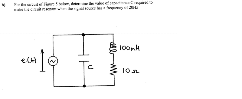

XL = wL
XC = 1/wC
XL = 4pi
Thanks in advance.
It does, where XL and Xc are the only impedances present. But there is an R here, and that makes things more interesting.jafferrox said:doesn't this mean XL=XC,
That gives a rough approximation, and will usually get you near the right answer, but can be wrong by up to about 15%.i already found XL and XC is the same and then solve for c?
