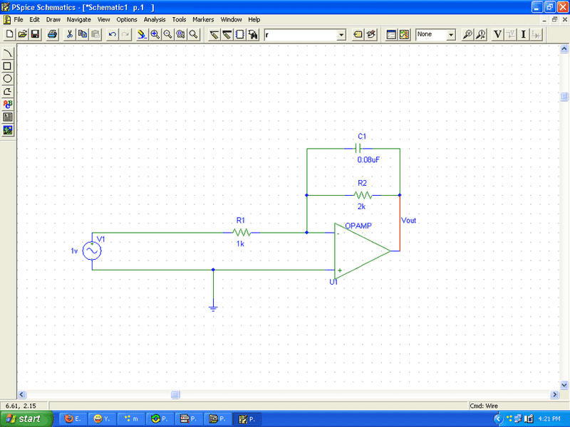

Hi everyone i got project from someone
Here is the Project
Code:
www.stanford.edu/class/ee122/Spice_Decks/pspicedemo.pdf
And i did the same what the pdf file tells
Here yall can see the video which i made
Code:
[URL]http://rapidshare.com/files/390247187/CaptureWiz005.wmv
[/URL]
Or
Code:
http://www.youtube.com/watch?v=4G82E2uDP2A
But rapidhsare one's quality is good
Circuit Pic
The graph which i want to invert
Can someone help me with inverting the graph?
What should i add in the circuit to invert the graph?

i made a circuit like this
But it gives me error.Isn't it same like high pass filter?i think it is but it is still giving me error

This is an inverting amp with a gain of A=R2/R1. i.e. Vout=AVin

You need to connect the positive side of Vin to C1 and the negative input to ground -- right now you've got the negative side of Vin connected to C1 and an open circuit on the positive side. And also remove the voltage source on the output, and put your probe here.
i removed voltage source and connected as u said
But the graph shows like this then
When I said "the positive side" I meant the terminal that has a "+" sign next to it. The negative side has a "-" sign next to it. I'm not sure what you're trying to do anymore, but in your last attached picture (which I guess is supposed to be an "integrator"):
1) Connect the positive output of Vin (marked with a + sign) to the 1k resistor and the negative side to ground.
2) Connect the negative input of the opamp to the node where the resistors and capacitor meet, and the positive input of the opamp to ground.If your input signal is a square pulse train, what do you expect to get on the output?

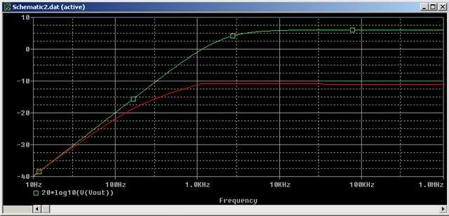

See the red lines i want graph like those red lines the red lines have been sketched in Paint to give me a clue that what graph will look like
Can u make like these?
Oops. Actually it is a high pass filter. I didn't see the capacitor at first. Sorry. The corner frequency = 1/2πR1C1 with a bandpass gain of R2/R1.

You can combine low pass and high pass filters to get passbands like that one.
[PLAIN]http://dl.dropbox.com/u/4222062/low%20pass%20high%20pass.PNG
Here R2 and C1 form a low pass filter to produce the slope from 10 KHz upwards and
C2 and R1 form a high pass filter to produce the slope from 1 KHz downwards.

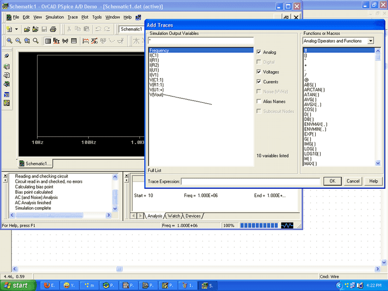

Vk6kro thanks bro i did it
Thank u so much i made a circuit like u have shown in the pic
I tried to make a graph like this but mine don't show like this
Can u make a circuit which can have graph like this on Vout
Could you show the circuit you entered into the simulator?
which one?
The one u made like it?
Or the one which i made wrong?
if u are talking abt the 2nd one then can't lol coz i saved and deleted the files coz it was wrong
I already have a copy of my circuit. To work out what you are doing, I need a copy of your version of it.
Try entering just the signal source and the first 100 K resistor R2 and C1. Then try entering the rest of the circuit but without the 270 pF capacitor.
You should get results like this:
[PLAIN]http://dl.dropbox.com/u/4222062/low%20pass%20high%20pass%203.PNG
Can you see that the combination of these outputs will give the bandpass shape I got before?

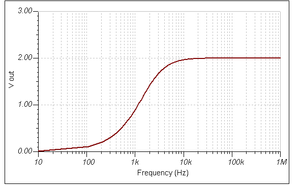

Anyone know how to make a circuit which can have graph like this on Vout
Yes, have a look at the first circuit in post #26.
That one peaks at 50 volts because the supply is 100 volts. You would need a supply of 4 volts peak.
R2 isn't necessary and you would get the same shaped graph without it, but twice as much output.
