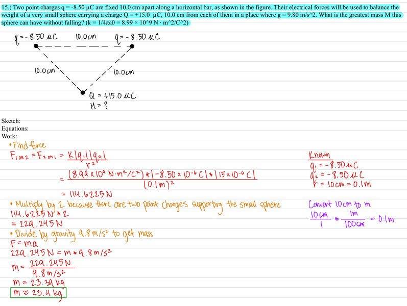

The correct answer is 20.3 kg, but I got 23.4 kg. What did I do wrong here? Please refer to part 3 for the problem question.
Refer to part 3.

It's the vertical component of the net electrical force that must balance the weight, not the sum of the magnitudes. Force is vector.
