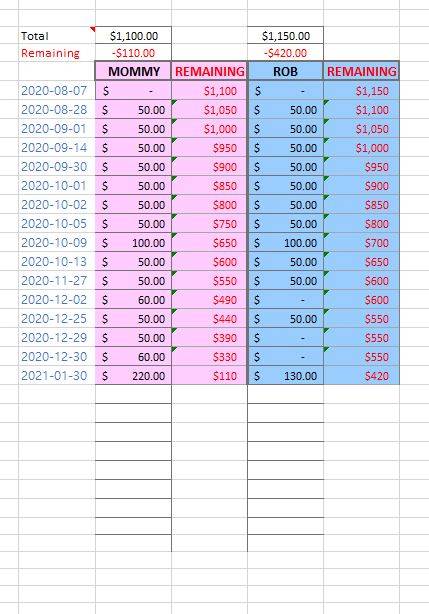

Hi, just some backstory: My mom and my brother Rob, both loaned me some money in August 2020. They each loaned me $1000.00. I decided to use excel spreadsheet to keep track of my progress paying them both back.

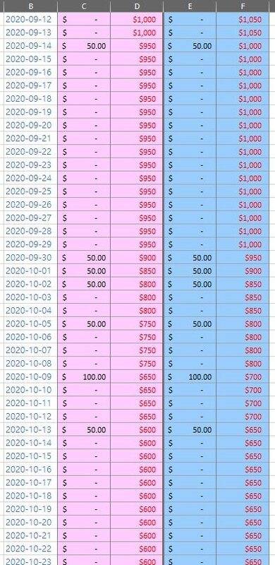

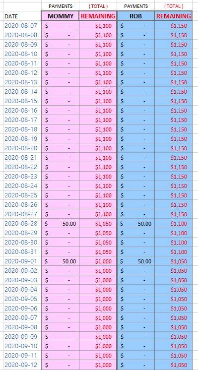

Okay so here is the data table I created; as you can see the progression of the date column is DATE + 1. When I make a payment towards either party i record the amount under the appropriate Payments column. The adjacent Remaining field gets subtracted by the amount just entered. Here see for yourself.

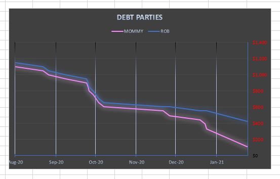

And from this data, here is a line graph showing my paying down debt.
But notice in the above data table, there's a lot of redundant rows (dates); dates during which nothing happened. I decided to trim these dates/rows and created (what I thought to be..) just a more compact but an equivalent table with the same amount of data.Here is the new table I created:

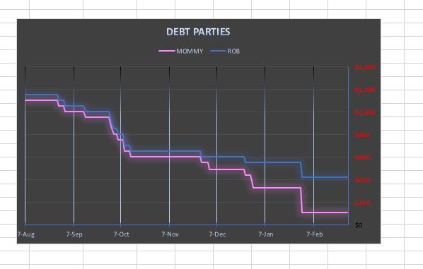

And here is the corresponding graph:

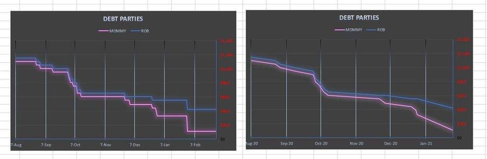

Yet if you look at the two graphs side by side they look quite different. I've made sure the two graphs' settings are all identical, so I'm at a loss.
If someone can offer an explanation as to why graph 2 is plotting the SAME data, differently, please do tell!Any helpful input is appreciated, Thanks!
You are missing the dates immediately before you repay something.
The original graph had a data point for 2020-08-27 at $1100, guaranteeing a straight line up to that day. The second graph is missing that, so Excel draws a slope from the $1100 at the starting point to $1050 at 2020-08-28.
The easiest way to fix that is to add a row each day before you pay something back.
