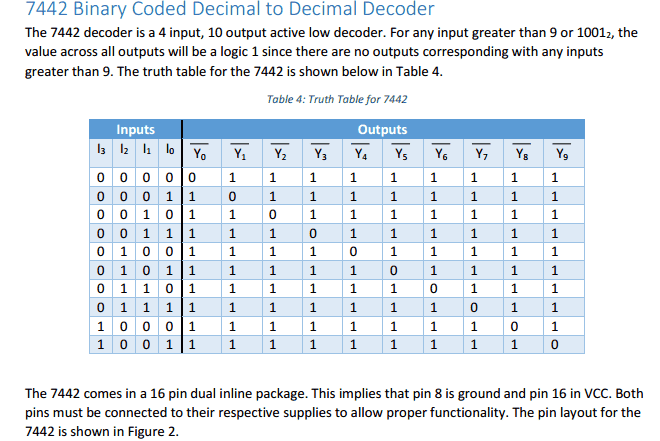

Furthermore, I'm having trouble understanding how my decoder works. I used a 4-to-10 decoder and that means that there are only a possible of 10 outputs. That makes sense to me as there are only 10 pins. However, my ram can contain much more information then that, so why wouldn't I be able to do ( with my decoder) 10 inputs of all 1 and one 0. And then the inverse.

The truth table of the decoder where it has 4 inputs and 10 outputs ( 4-to-10). As shown here:

The point I was asking is that if the decoder has a maximum of 10 inputs ( 0000 to 1001 as the table shows above) and those are active low, would it be possible to add an extra 10 inputs ( so from 1010 and on) just by inverting the signal?

As for my decoder I asked, separately that is, 1) why is there a maximum of input from 0 - 10.
There are NOT a maximum of 10 inputs, there are 4 inputs. There are 10 outputs.
I get it's a 4-to-10 but wouldn't it be possible to create more if we inverted it from active low to active high creating a new sequence?
As I already said, sure you could get more but you would STILL only have 10 unique outputs.
2) How does it display on the LED?
You hook each of the 10 outputs to a LED and when one line goes low, that LED lights up (you connect all the other sides of the LEDS to a power source and possibly a current limiting resistor).
So if you get an output of 6 being active low, how would the LED know which light to light up to create the the number 6 (0110).
It would "know" because it would have current flowing through it.
