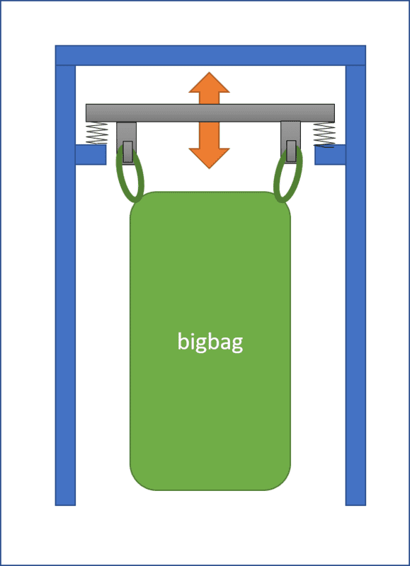

Help with choosing the right mechanism for high load 'shaker'
Hey there. I am hoping you guys are willing to share some experience/knowledge.
Im a young engineer and i would like to expand my knowledge on mechanical engineering.
Currently I am trying to develop a densifier for material inside BigBags.
The bigbags are loaded with particles up to a total of 700kg. The bb are hanging in some clamps. The basic setup is shown in the attached file.
I came to the conclusion that i want to shake the bigbag to get the result i need. I tried putting it on a vibration table but this was not effective enough.
I want to raise the whole bb in its loops. Then drop it like 100mm and catch it again. this way the wieght of the material pushes down the material below. I've been looking at cam shafts, crankshafts, unbalance motor, gear racks and spur gears, custom mechanism with a cilinder that hooks and unhooks, pneumatic bellows and so on...
But i have a hard time deciding what mechanism would be best for minimal energy consumption and minimal maintance.
Im not asking for a full design, but i would like a head start in what general direction i can go. I really hope someone can help me out!
I hope I've been clear enough. Otherwise please ask for more information. Thank you!

Thanks for the response. like i said before, a vibration table does not work with our product. The vibrations don't travel trough the whole bag. I have tested this option by renting a table like your example. I try not to invent the wheel again but i don't see another available option.
Maybe this helps:
Currently we shake the BigBags with a forklift. We raise the bag ca 5-10 cm and then we drop it. This is an expensive option.

Thanks Tom. I've thought about enclosure walls for the compactor. Yet i would still be left with the screw being under high force and it will probably wear fast.
I'm also scared that a very aggressive shaker table doesn’t work because the particles keep jumping around instead of moving to a "gap". I am able to apply the shaker table idea while the bag is being filled. This works especially well in the first part of the filling. The more material the less effect it has.
I want to look at some replacement for the forklift to achieve, like you said, both compression and deforming. So i want to shake the bag more aggressively than a shaker table.
So what would be a good way to achieve a linear, vertical motion, with a relatively low frequency and 5-10cm displacement. I’m now trying to see if a crankshaft or camshaft would be best.

hahaha! Bigger screw is not a bad idea... Do you mean that i can use a ball screw to raise and then drop somehow?
I'm thinking about testing a hydraulic shaker. Maybe with a very low frequency, high amplitude.

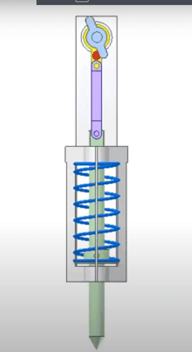

There are so called snail cams. They allow for rapid downward acceleration. I think i need 1G not more or less. The bag won't drop faster than G allows and i don't want to catch it on it's second rotation.
I was also thinking about a system like shown in the attachments.
The yellow plate moves freely. The blue one rotates continuesly. Every rotation the red pin(and also the yellow plate) gets pushed around by the blue cam. Once it passes it's dead center on top, the yellow plate and the connecting rod can fall freely until it reaches its bottum position, waiting for the blue cam to push it around again. The BigBag hangs in a "hanging" which is connected to the slider. The slider gets moved by the connecting rod. Do you think a system like this could be robust enough?
Last question first: almost anything can be "robust enough" with enough material in it. I am a little confused about its operation though. If the bag is suspended by the Green shaft at the bottom, at the most the spring will allow the bag to free-fall for a short distance. But you don't need the spring. When the pin gets past TDC, the bag will free-fall anyhow,

Tom.G said:
Hi @teun-lll, I got busy yesterday and didn't get on-line, hence the delay.
Allright i think i have to explain my idea a bit better. The spring needs to change so that it just absorbs some of the shock from falling. I want to do this so there would be less sound and less wear. In the example i sent it accelerates the green shaft on its way down. I indeed don't need this.
I like this mechanism because of the freefall feature. Otherwise i have to match the rotational speed of the crank/cam so that the pin does not go up when the bag is still falling.
If i want a 5 cm displacement. I think i need about 90 rpm so the bag will still fall all the way down before getting picked up. This would be without the freefall mechanism.

We fill the bag from the top with a conveyor belt. We hang the BB like the drawing in the attachment(without the springs)

There is a thing called 'vibro compaction'. It's usually used on soil, but I think you can adapt it (without the water part, of course).
The point is, that the 'pin' makes room on the bottom with vibration (pushing aside the material below and using the weight of the material on top) so you can keep the top feed.
Maybe even with four 'pins' in one go.
