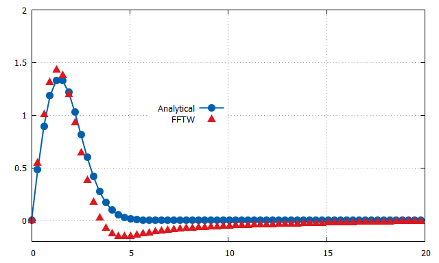

Hi,
I am a neophyte in Discrete Fourier Transform and I am procticing with discrete Sine-transform.
Specifically I want to calculate $$ \mathcal{F}_s \lbrace x \cdot e^{-x^2} \rbrace = \int\limits_{0}^{\infty } x \cdot e^{-x^2} \cdot \sin\left(x\right)\, \mathrm{d}x
= \frac{1}{2} \pi^2 \omega e^{- \frac{1}{4} \pi^2 \omega^2} $$
I am using the FFTw library and with a 64 points I get a very poor result. Can anybody please help to improve it?
This is my C++ code, plot and numerical data are attached.
Thank you very much in advance

Hello Scottdave,
thank you very much for your hint, my post looks definitely better now.
I hope that you can see the attachments now
  • Code.txt
Your original equation has a typo (sin(?)). It would be helpful to give more information about the graphs - which is which?

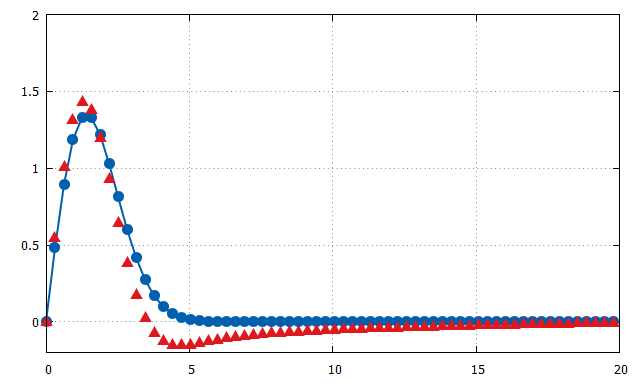

Hi mathman,
the original equation is $$ f(x) = x \cdot e^{-x^2}$$ . Its analytical sine-transform is given by
$$ \mathcal{F}_s \lbrace f(x) \rbrace (\omega) = \int\limits_{0}^{\infty } x \cdot e^{-x^2} \cdot \sin\left(x\right)\, \mathrm{d}x
= \frac{1}{2} \pi^2 \omega e^{- \frac{1}{4} \pi^2 \omega^2}$$
I uploaded the plot again with a legend

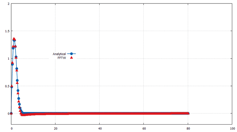

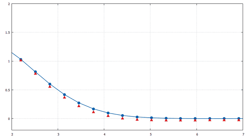

Sorry for the typing error,of course the the correct argument $$\sin \left(\omega x \right)$$. The resolution is still poor even with 256 points Can anybody tell me where the deviation between 2.0 and 7.0 comes from? (please see attachments).

Hi kaniello,
There seems to be a bit of a mixup with factors pi.
W|A (link) reports the sine transform to be:
$$\mathscr F_s\{xe^{-x^2}\}(\omega) = \frac 1{2\sqrt 2}\omega e^{-\frac 14 \omega^2}$$
Of course we can have a different normalization constant than the one given, but not a different argument to the exponential function.
Anyway, if I do a discrete Fourier transform on the data, I don't get the dip that you're seeing between 2 and 7.
So it appears there is something wrong with that FFTW routine that you're using.
Unfortunately I'm not familiar with it.
I do notice that the dip might be explained if the cosine transform somehow crept in - that one does have a dip between 2 and 7.
And I guess it might also be caused by a filter (window function) that is applied before applying the FFT.
Have you tried using an FFT routine from a different library?
