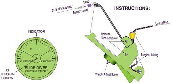

Here is a picture of the diver:

Do you have a diagram that shows the entire picture of how your apparatus is used - one that shows everything from the boat to the end of the line in the water? I don't understand how the "ring" and "angle" settings affect the geometry of the problem.
Unfortunately I don't have such a picture, but I'll explain how those things work the best that I can.
Rings: With the addition of either the #2 or #3 ring the surface area of the diver is increased. As you can see in chart #1, to achieve a depth of 30ft you need to release less line with the increase in surface area (ring #2 & #3). It basically increases the performance of the diver, the more surface area it has the easier it is to control it.
Angle: The main purpose of adjusting the weight position (i.e. angle) is to allow to cover more water area. Say for instance you put three lines off the right side of your boat without an adjustable angle. You would end up dragging three divers directly behind your boat resulting in a tangled mess. An angle setting of 6R will tilt the diver in the water sending it out about 90 degrees off the right side. So three divers at different angle settings might look something like this;
http://www.u-charters.com/img/no_angle.jpg
http://www.u-charters.com/img/3_angles.jpg
Hope this helps.
Those diagrams were helpful. Let me make sure that I understand a very elementary point. Other products on the web that I see which are "divers" for trolling have a streamlined look and I think they are mean to be pulled under the water. Is the appartus you are dealing with like this?
If so, let me ask you about a possible simplification of the problem. Suppose that the diver is moving along under the water at a known speed and depth and we have a given length of line attached between it and the lure or bait. Would that be enough to determine the depth at which the lure is riding? ( For example, I can see that if the wake of the boat somehow affected things, we would need to know how far the diver was from the boat. But do things like that really matter if you know the depth and speed of the diver?)
The above thought suggests that the problem could be subdivided into two parts. Part 1: Get data on how the variables ( speed of diver, depth of diver, length of line from diver to lure) determine the depth at which the lure rides. Part 2) Get data on how (speed of boad, ring setting, angle setting) affect the depth at which the diver rides.
