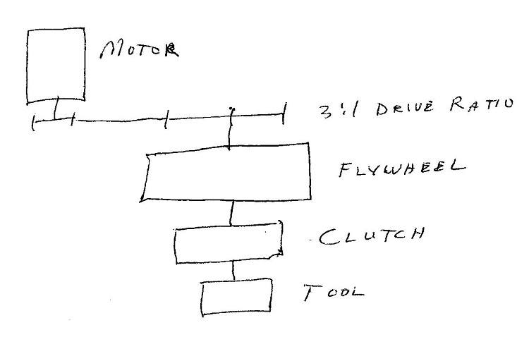

Hey everyone,
I have a problem with sizing a clutch for my machine. My problem is, I don't know how to calculate the needed value (Nm) for the clutch to withstand the torque affected by the flywheel. I have a flywheel that weighs 90kg and is 600mm in diameter. It is rotating at 500rpm (52,36rad/s) via electric motor and 1:3 gear ratio. Torque transmitted to the flywheel constantly is around 60Nm and inertia of the flywheel is 4,05kgm^2. After the flywheel at its shaft is toothed clutch, that connects the shafts of the flywheel and the cutting tool. The flywheel rotates constantly and at desired time the clutch is activated and the cutting tool starts rotating with the flywheel.
Problem is, I don't know how to calculate the needed value (Nm) for the clutch. I know it usually is calculated with acceleration, but in this case I don't know it. The cutting tool rotates 180 degrees at a time, and will do the cut within 90-120 degrees from its starting point. Since the tool is rotating at 500rpm, it takes 0,12 seconds for the tool to rotate once. I'm not sure how to explain this better, so if I left out some important values, please let me know. If anyone could help me with my problem, I would be really grateful.

Does this schematic diagram correctly show your system?
Your description sounds like a mechanical punch press, where the motor spins up the flywheel, the operator engages the clutch, the driven shaft makes one revolution, then the clutch is pushed open by a cam.
We need to know if this is correct. If not, we need to know exactly what you are trying to do.
Likes Mattuu, Lnewqban and Twigg

Yes, this is on point. I started the whole design based on eccentric punch presses.

Thank you all for your answers. I haven't done calculations regarding this kind of machines before, so if there is some info that you need and I didn't provide, please let me know and I will do my best to provide it.
If the flywheel is big, the motor is irrelevant in the time frame you care about, that's why you would put a flywheel in the machine. The issue is essentially the same problem as "how do you connect a large spinning flywheel to a smaller, initially stationary flywheel." This is roughly the rotational version of slamming an fast car into a slow car and asking how much force will the bumper feel.
Thanks for the followup!
In the worst case scenario, let's say the workpiece brings the flywheel to a stop. As a first approximation, the torque of impact will be given by the change in angular momentum divided by the time of the cut. The actual torque can exceed this value, so I would throw a hefty safety factor on this. $$M = \frac{L_{flywheel} - 0}{t_{cut}} = \frac{I_{flywheel} \times \omega_{flywheel}}{t_{cut}}$$
The time of the cut you can approximate from the initial RPMs and the fact that the cut takes place over 90 degrees per your original post: $$ t_{cut} = \frac{\pi}{2} / (2\pi \times 500 RPM) = 30ms$$ This is an underestimate of the time (overestimate of the torque) because the cut slows from 500 RPM to 0 during the cut.
You know ##I_{flywheel} = 4,05 kg \cdot m^2## and ##\omega_{flywheel} = 2\pi \times 500RPM = 52 rads/s##, so ##M = 7,02 kN\cdot m##. Throw a big safety factor on there. Even if this won't cause a clutch failure on the first go, metal fatigue is a thing.

The toothed clutch is a dog clutch (search the term). Dog clutches are commonly used in mechanical punch presses and outboard motor lower units for forward - neutral - reverse shifting. They engage with a clank because the driven load goes from zero to full speed "instantly". "Instantly" is in quotes because every part in the driven system from the driven dog clutch member to the load is elastic. That elasticity is what allows the parts to survive repeated engagements. Dog clutches require low inertia driven loads.
The clutch must be strong enough to survive the shock of engagement. There are no good calculations for engagement force because it is entirely dependent on the inertia and elasticity of all of the parts being driven. I have seen attempts to compare the kinetic energy of the driven load to the maximum elastic strain energy in the dog clutch. In the real world, the best approach to designing a dog clutch seems to be to copy one that works in a similar application, and test it. If if breaks, make it stronger.
The next load is the force of the tool against the workpiece. That force could be greater than or less than the peak engagement force. The dog clutch needs to be strong enough for the work force, and that force can be calculated.
The last load is the crash load. Something goes wrong and the press jams to a dead stop. Real world punch presses have been destroyed by this. The remedy is to design a weak link that will fail first. The weak link could be the drive side of the dog clutch, the driven side of the dog clutch, the driven shaft, or a shear pin in the system. Good practice is to design a low cost weak link, such as using a bolt for a shear pin.
